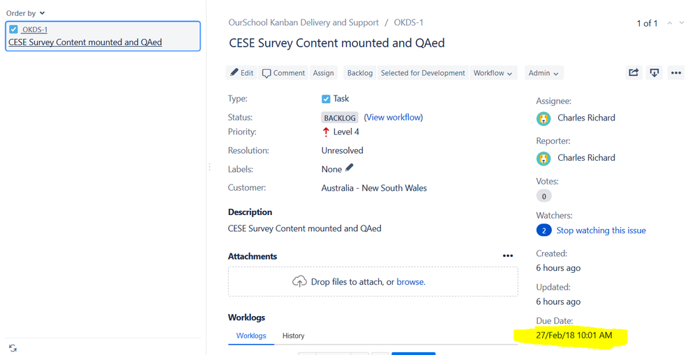

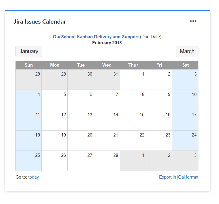

I'm doing an experiment with a Kanban board and also setup a Jira Issues Calendar to see if I could use it to view Client Deliveries that are due in a month.
I setup a task with a due date of Feb 27th but the calendar is not showing it. See attached snapshots.
Any suggestions?

Charles Richard January 29, 2018
Thanks Fadoua!
The problem was that I needed to switch between the due date and another field and then switch back to the Due Date and it worked. Feels like a bug but this did the trick!

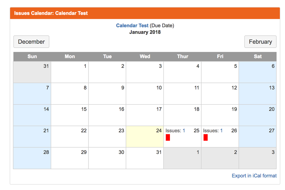

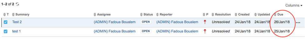

Hi Charles,
First of all thank you so much because of you I learned something new today.
Attached are my screenshots from my dev instance. When I used saved filters, my calendar didn't display any issues with upcoming due dates.
When I created a new filter it worked.
