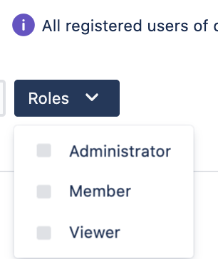

Mayank June 9, 2020
Hi Angélica,
Thanks for the response and for looking into this.
I do not think there was any change in role setting.
I have both member and admin role and I tried switching to the Admin role alone as well. Where can I confirm if the default `Administrator` role has "Manage sprint" permission?
Angélica Luz
June 10, 2020
On the Access page, click on Manage roles:
Then, you can click on the roles to check the permissions and confirm if the Manage Sprints were marked. Both Member and Administrator should have this permission.
Mayank June 10, 2020
Thanks. I can confirm that this role is available.
