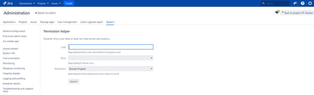

Hi @Oliver Blaskowitz , thanks for your question.
If you are a Jira admin, you can access the Permission Helper in the system settings to check for any blockers to the user being able to create in the different projects.
So, here^ you would put the user and the create permission to see what the results are.
Please can you try this and see if it helps you?

Hi @Oliver Blaskowitz , thanks for your reply. It can be the case that a user can have the create permission but not the browse projects permission. I know it doesn't make sense logically but it can happen if someone is a member of a group that gives them permission that maybe they otherwise don't need. Have you checked this?
