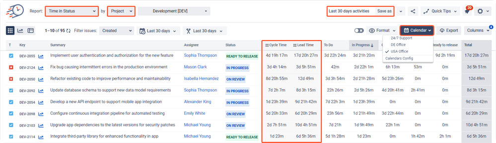

Time between Statuses is the add-on, which measures connections in the workflow, through a transition time in specific issues. You can count Cycle and Lead Time by setting start/stop and pause statuses in the configuration manager. To detail the calculation conditions you should select the first/last transition to/from status.
You can customize your Cycle and Lead Time reports by adjusting the app interface fields such as: Type of Project Date range Time Format Multi Calendar (to configure non-working hours and different calendars.) This add-on also allows you to export data in XLSX or CSV formats.
Time in Status will be an option for you too. Add-on get your Cycle and Lead time by setting Status Groups. You can configure it from your account at the Column Manager with the drop-down list of the statuses.
A custom report can be placed on the main Jira dashboard with the special Gadget tool, and you can export data in XLSX or CSV formats.

Hi @Drew G
As an alternative, you can try our addon:
The add-on provides the time for each status in the issue lifecycle.
You can also create a Dashboard gadget out of it with graphs too.
Also there are 20+ reports in the app which help to meet a wide range of use cases.
