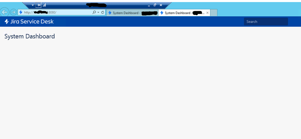

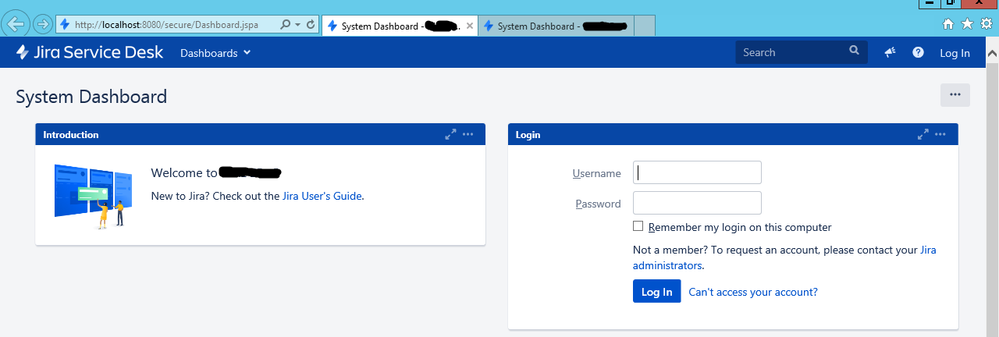

I have installed a instance of Jira Service Desk for Server, the base url of the appltication is set using the server's IP address. I cannot see the screen in browser using this IP address only the localhost address. The page is loaded, but it is incomplete as you can see in the attached pictures.

I talked to them but that would be difficult to modify the DNS to point to that IP address. Meanwhile I tried with Chrome and it works fine. It seems that is happening only in IE. But here is the problem, we have a videowall solution that works only with IE, and I cannot show on the videowall the actual screen of the application.
If it helps I noticed that the controls in the application are active, there are only the pictures of them that don'l load correcty.
