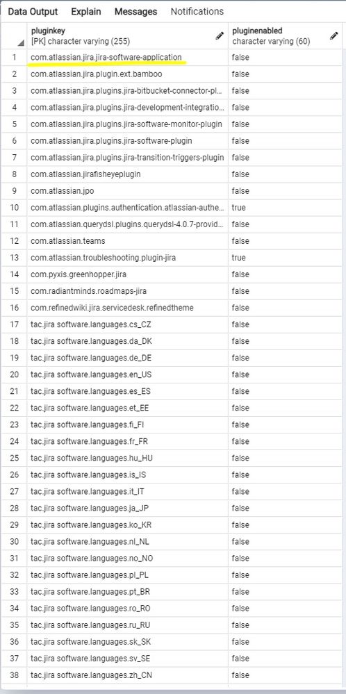

In try to figure out how to get Jira Software re-enabled I am looking around the database to see if there is anything in there that would help. I don't have another system to compare to but does this look correct?

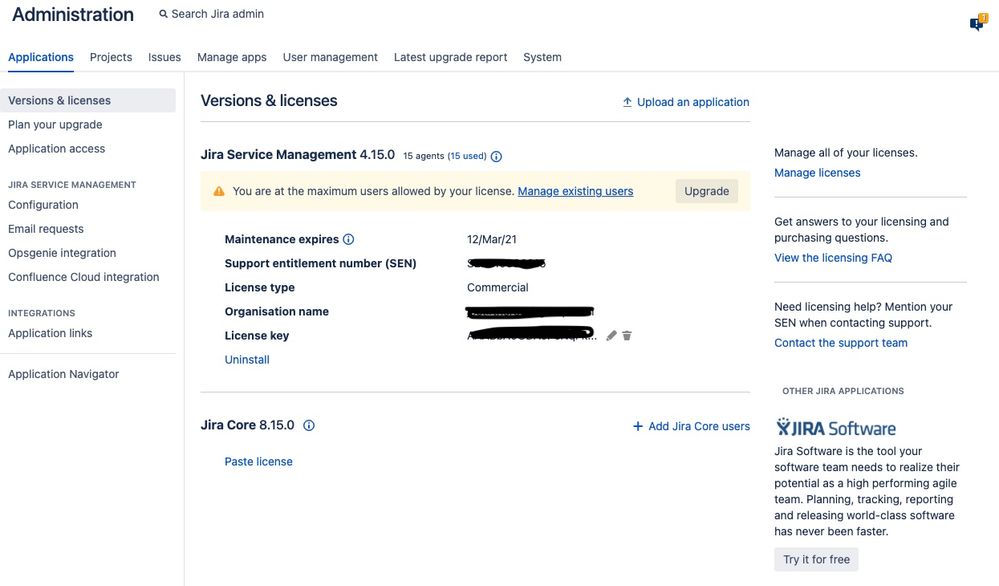

What does your application page look like right now? Can you share a screenshot?
Does it just show that the app is not installed?
Correct, this is what the Versions & Licenses page looks like. I have tried to click the "Try it for free" button on the bottom right of the screen, hoping that would install the software and I could paste License key in. However when I attempt to install this way that is when the process fails and the GC errors begin (during this install).

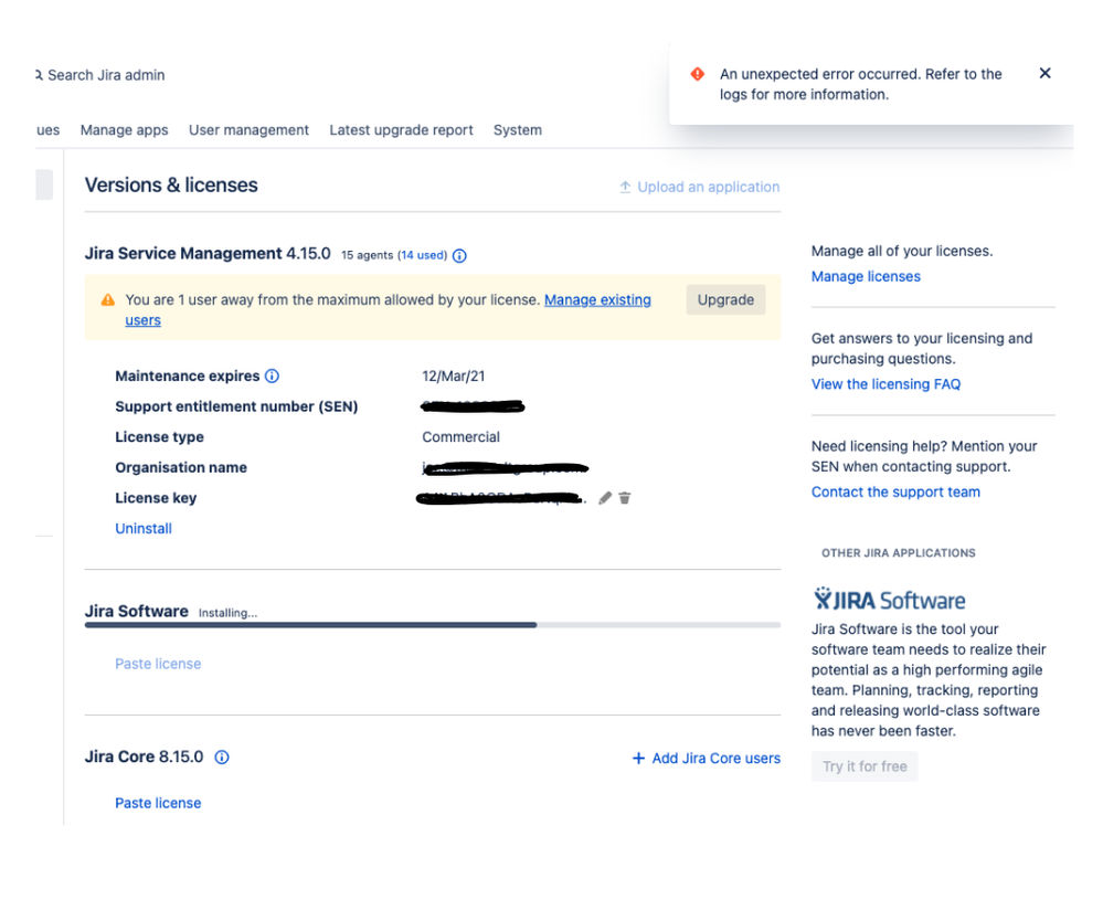

If you install using upload an application, what happens?
Also have you tried restarting Jira?
Yes I have restarted many, many times.
I am unable to find just the jira-software install, other than the server install. I would love to give that a try if is exists.

You can download the application Jira Software from here: https://www.atlassian.com/software/jira/download Can you try installing and sharing the logs of what occurs during install.
Ok that didn't work as hoped. So I went into the database and replaced false with true on this entry com.atlassian.jira.jira-software-application in the pluginstate and I was able to get Jira Software back and licensed, although I appear to be missing the actual functionality.
While, I was not able to successfully down and install Jira Software this way, it looks like it just times out with zero feedback.
I went into the database and enabled the plugin for com.atlassian.jira.jira-software-application to true and restarted Jira.

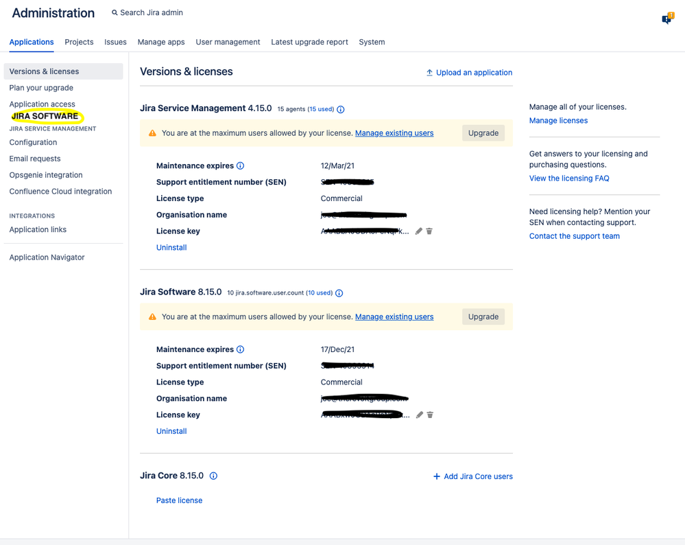

I was able to get the Jira Software back and add a License key, however it does look like I have any of the actual functionality of the app. As you can see its missing the Jira Software conf menu item on the left.
Progress. Can you look at this - https://confluence.atlassian.com/jirakb/jira-startup-fails-with-message-that-required-plugins-are-not-started-254738702.html
There are most likely additional apps that need to be enabled.
Funny enough, right before you sent this along I went back into that table and set all plugins to true and that did the trick.

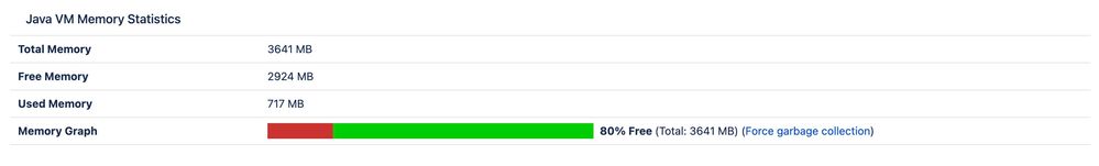

2021-02-16 20:45:37,548-0500 JIRA-Bootstrap INFO [c.a.jira.startup.LauncherContextListener] Memory Usage:
Heap memory : Used: 731 MiB. Committed: 2018 MiB. Max: 4018 MiB
Non-heap memory : Used: 342 MiB. Committed: 373 MiB. Max: 1536 MiB
TOTAL : Used: 1074 MiB. Committed: 2390 MiB. Max: 5554 MiB

One more thing, the memory screenshot that you have provided, is this during the Jira Software module installation?
If it's really the GC problem, then you will need to analyze the GC logs as per Troubleshoot Jira Server performance with GC logs.
