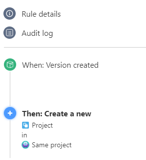

The rule should create a new custom Issue Type named 'Project' when a new Version is added under the same Project's Releases.

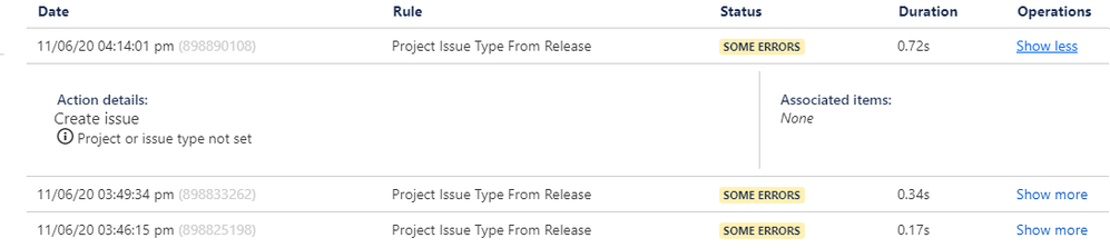

The problem I have is that I always get an error stating "Project or Issue Type not set".
rulefail.pngI'm having a hard time understanding what that error means.  The rule is explicitly scoped to a single project and the "Create a new" action definitely indicates the Issue Type it should create.

Atlassian support solved this problem.   The rule's Create Issue Action needed to have Project set to "Same project as trigger" and not simply (the default) "Same project" -- which, at first glance, appears equivalent.
