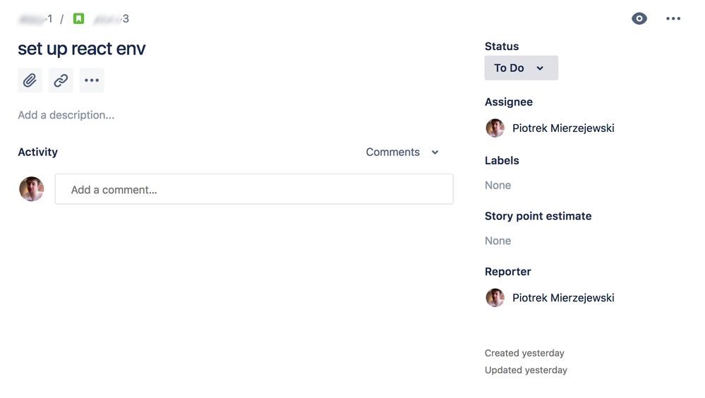

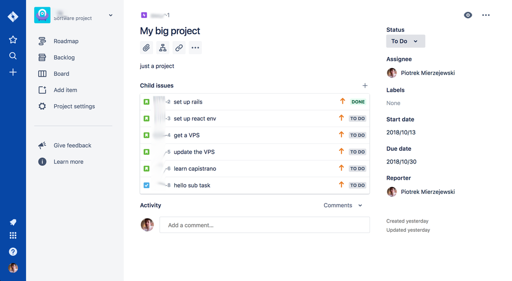

@Andrew Zibuda: I don't think so, here's what it looks like in Jira:

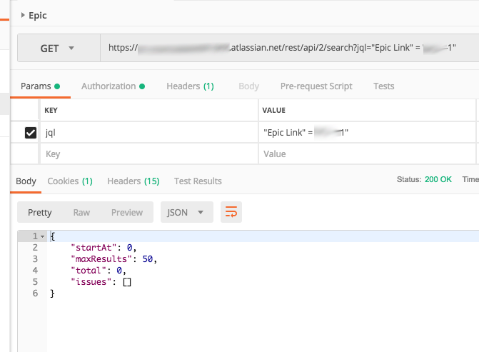

Alright so I don't see any Epic Link field like we have but if you can find some linking field you can do a GET search based on that, this is the way we get all issues in an Epic:
get("/rest/api/2/search")
.queryString("jql", "\"Epic Link\" = \"$epicKey\"")
.asObject(Map)
@Andrew Zibuda it doesn't return any results, so I think the Epic Link field isn't used in this case.
