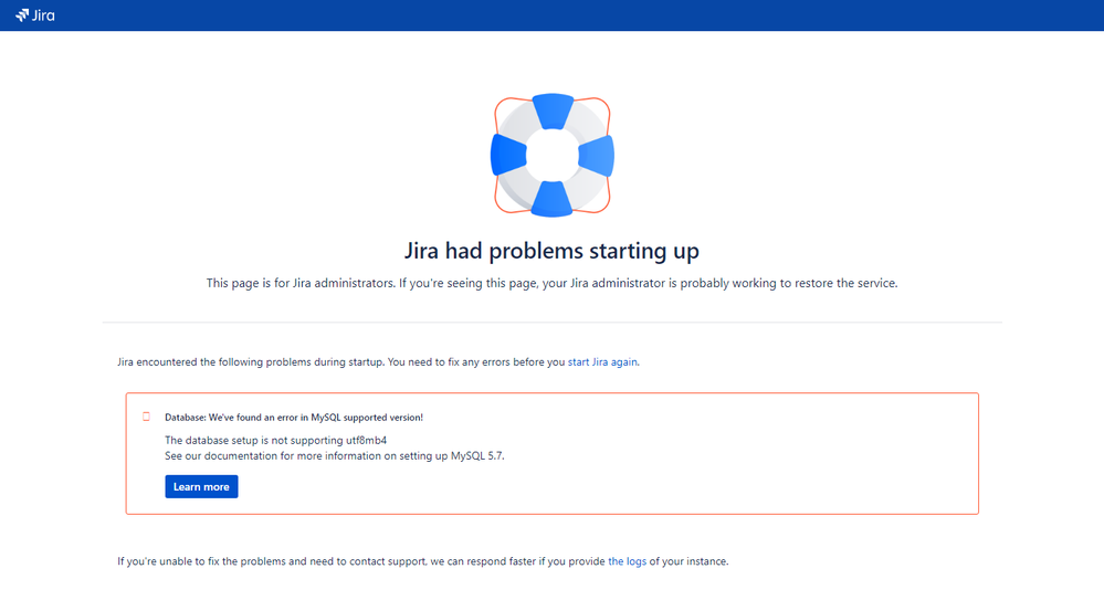

Deleted MariaDB and installed MySQL, now stuck on
'Database: We've found an error in MySQL supported version!
The database setup is not supporting utf8mb4'

Hi @gf ,
So it looks like you need to have an updated MySQL Driver for 5.7 version and enable the utf8mb4 in mysqld configuration.

I'm making progress with MySQL now with the following you stated in link above;
Though I followed it before and didn't get anywhere, it is because they missed out a semicolon ';' in the KB/guide.
ALTER DATABASE yourDB CHARACTER SET utf8mb4 COLLATE utf8mb4_bin;
SELECT CONCAT('ALTER TABLE ', table_name, ' CHARACTER SET utf8mb4 COLLATE utf8mb4_bin;')
FROM information_schema.TABLES AS T, information_schema.`COLLATION_CHARACTER_SET_APPLICABILITY` AS C
WHERE C.collation_name = T.table_collation
AND T.table_schema = 'jiradb'
AND
C.CHARACTER_SET_NAME != 'utf8mb4'
OR
C.COLLATION_NAME != 'utf8mb4_bin'
However, I've had to let Jira do the auto setup to for it to work and then change licence. Exhausting!
