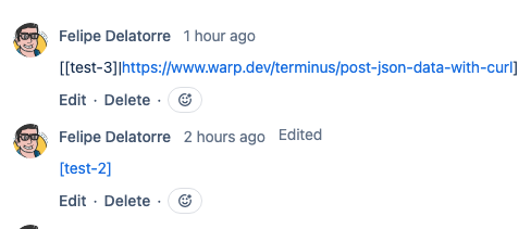

Im trying to send an API Post request to `/comments` with the contents of a link. When the link content contains brackets the formatting breaks. This does not happened when using the UI to create a link (see test-2). But when using the API and sending the exact payload the UI does not format it properly (see test-3).
Below is the response when retrieving those two comments using the API we can see they are identical, yet they are displaying differently.
Could I get example payload of what I could send to achieve the results of test-2? I have tried escaping it in different ways with no good results.
Thank you!
"body": "[[test-3]|https://www.warp.dev/terminus/post-json-data-with-curl]",
"renderedBody": "<p>[<span class=\"error\">[test-3]</span>|https://www.warp.dev/terminus/post-json-data-with-curl]</p>"
"body": "[[test-2]|https://www.warp.dev/terminus/post-json-data-with-curl]",
"renderedBody": "<p>[<span class=\"error\">[test-2]</span>|https://www.warp.dev/terminus/post-json-data-with-curl]</p>"

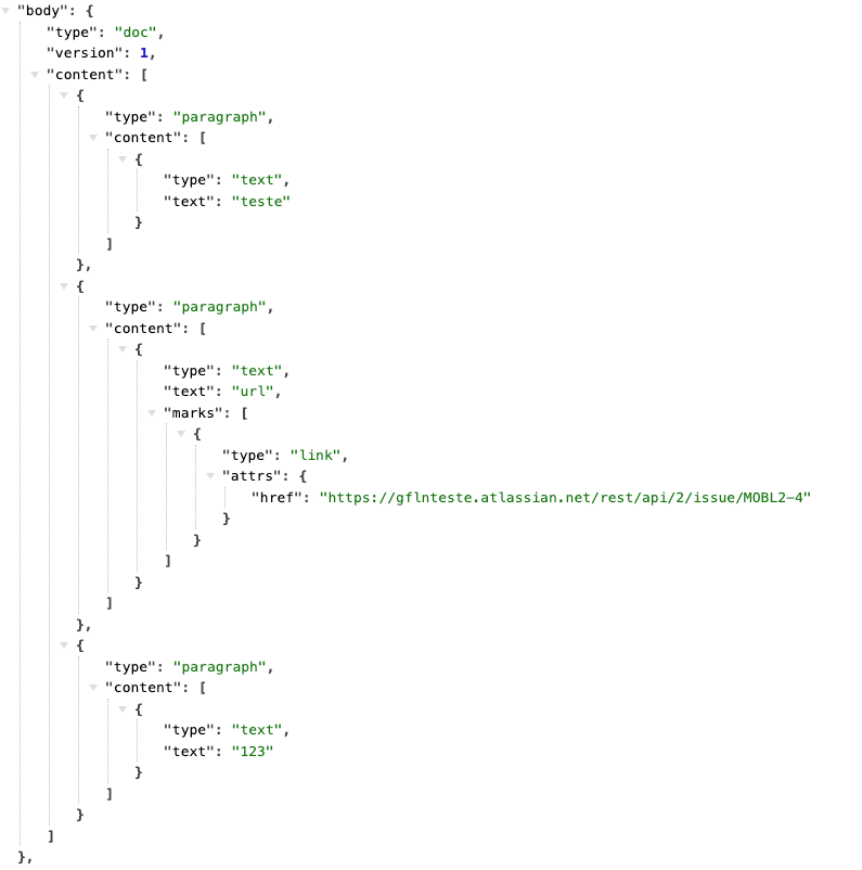

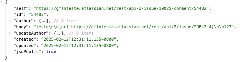

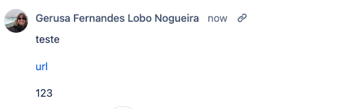

Hello @Felipe Delatorre
There is a difference between Version 2 and 3 for the API for jira cloud comments.
In version 2, the comments payload uses a markdown format.
POST {url}/rest/api/2/issue/{issueIdOrKey}/comment
"body": "Lorem ipsum"
In version 3, the payload use a json format, allow more details divide blocks with text, links, media, and other types.
POST {url}/rest/api/3/issue/{issueIdOrKey}/comment
"body": {
    "content": [
             "content": [
                           "text": "Test 123",
                           "type": "text"
             "type": "paragraph"
      "type": "doc",
      "version": 1
You can see the correct format, using in browser the issue endpoint, as example in bellow:
Using version 2: https://{url}.atlassian.net/rest/api/2/issue/{issuekey}
And using version 3: https://{url}.atlassian.net/rest/api/3/issue/{issuekey}
I hope help you.
