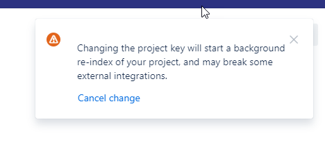

Another question to raise here: If I change the project Key in my destination project to somewhat match the previous one, will that also cause any problems? I tried to do that, but once I saw the alert message, I held off on that.
Typically this is okay to do as long as you don't have a lot of connections to third party tools like GitHub/GitLab, etc. How many issues are in the project?
Sorry, I didn't notice your comment. I have 110 issues in my project. :)
