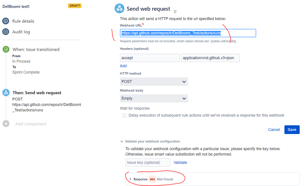

appreciate your quick response. I got your point but when i set up an action, i do get only option as Submit Web Request and that only asks for WebHooks. I tried to provide RestAPI URL which works locally with me, but in Jira i always get 404 response. Is there any other action i should try for RestAPI.
Please notice that 404 means page not found and therefore there are chances you are calling the wrong URL. Also, I don't see any authorization header configured.
Can you confirm that you are trying to call the below endpoint?
If that's correct, can you run the same REST API call using Curl as per the example in above page and paste the result in here (making sure to remove all the sensitive data like username, auth token, auth header, etc).

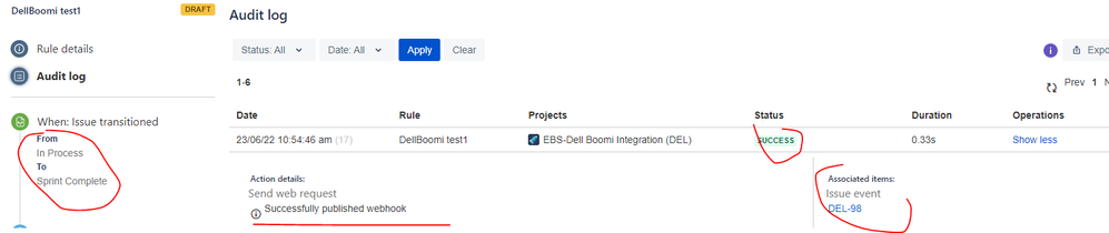

Hi @Dario B first of all many thanks for your support and a big apology from my end, i found the mistake was making during this run, forgot to pick right HTTP method according to different API, now its all sorted and working fine. Thanks a lot.

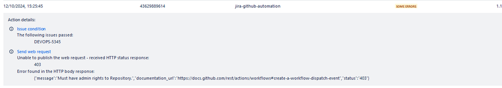

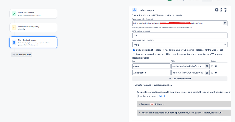

hi @Hemant Goel i am also looking for jira issue status change like status changed from inprogress to closed , or resolution comments are added to jira , it should close the curesponding pr /issue for the github event
i am creating jira issue from githubactions on the event of pr created/ issue created .
once issue is created any update to jira issue should reflect in github as well .
i am use github-jira as label for jira issues
i configured jira automation rule as
audit logs of automation rule has
