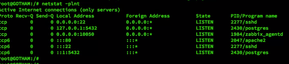

5-) After restarting the JIRA and CONFLUENCE as a service, the LISTEN PORT status are as below;
The below status is when everthing has been working smoothly.

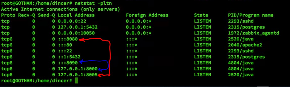

The below picture is from old times when both Confluence (8090 port)  and Jira (8080 port) have been working smoothly.
