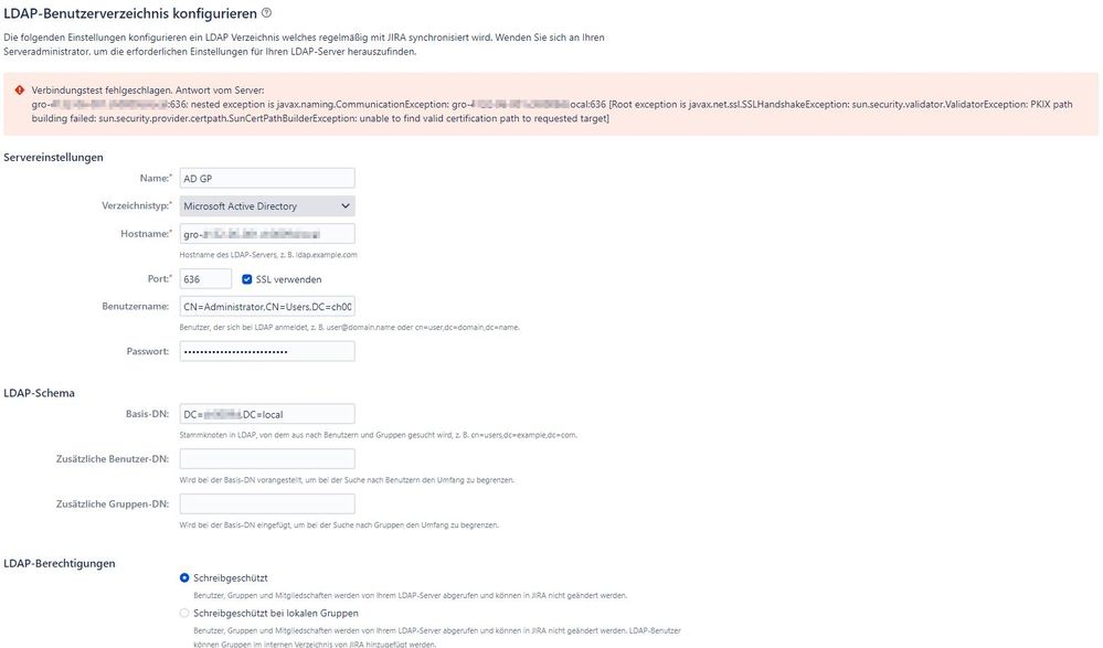

We have now the Problem that one of the Domains is working with ldaps and the other not.
Here ist the Error MSG:
Verbindungstest fehlgeschlagen. Antwort vom Server:
DC1.DOMAIN2.local:636; nested exception is javax.naming.CommunicationException: DC1.DOMAIN2.locall:636 [Root exception is javax.net.ssl.SSLHandshakeException: sun.security.validator.ValidatorException: PKIX path building failed: sun.security.provider.certpath.SunCertPathBuilderException: unable to find valid certification path to requested target]
We have added the Cert of the DC1.DOMAIN2.local the same way as for the DC1.DOMAIN1.local
keytool -importcert -keystore "C:\Program Files\Atlassian\Confluence\jre\lib\security\cacerts" -file DC1.DOMAIN2.local.cer
In Case of the upper Error we added additionaly the Root CA of the Domain B to the cerststore
keytool -import -trustcacerts -alias DC1.DOMAIN2.local -file root-ca.cer -keystore "C:\Program Files\Atlassian\Confluence\jre\lib\security\cacerts"

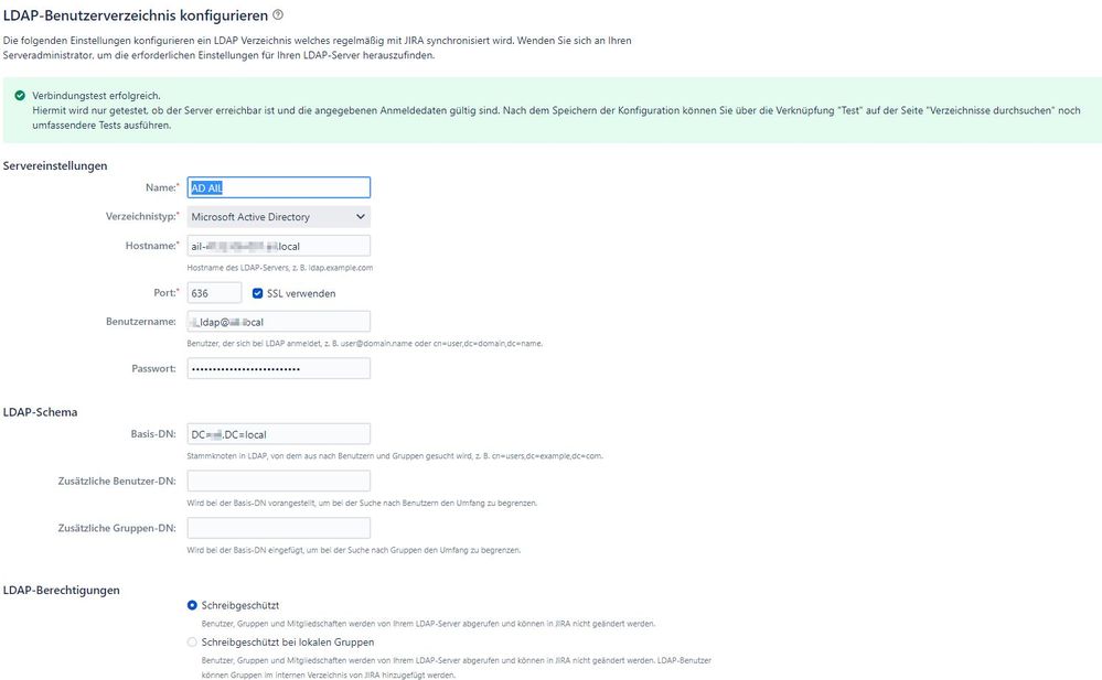

On the Jira are 2 LDAP Query Configured Pointing to DC1.DOMAIN1.local and DC1.DOMAIN2.local over Port 636
The SSL checkbox is on.
The Query is working over LDAP. So the whole AD query User and the LDAP Path is working.

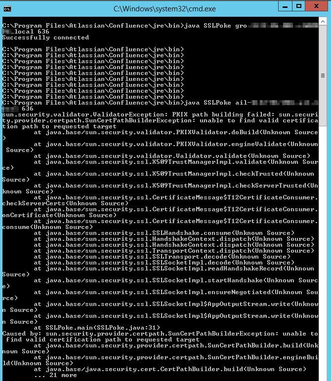

So a little Update of this Problem.
I tryed to troubleshoot this issue with this:
https://confluence.atlassian.com/kb/unable-to-connect-to-ssl-services-due-to-pkix-path-building-failed-error-779355358.html
So first the Issue
With this Domain it is not working.
With this it is working
On the Jira Server with the SSLPoke Java tool the Problem is inverted.
So in Jira the gro domain isent working but the AIL
In the SSLPOke the gro domain is working but the AIL not.
And Finaly with the used Keestore from Jira i guess.
Could there be any know issue with jira or better Java that only one LDAPS connection could be formed in one Java Session?
