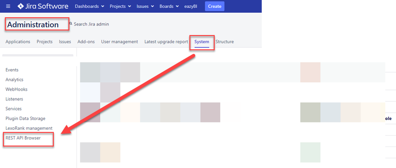

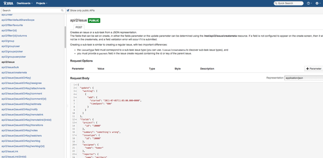

First you need to identify the available REST webservice calls available for JIRA.
There is an addon in the Atlassian Marketplace called Atlassian REST API Browser. This is a free addon developed and provided by Atlassian. Download and install this addon in JIRA.
Once installed, you will be able to access it in the Administration Section --> System --> REST API Browser.
Here you can see a list of all available calls for JIRA.
Each call supports one or more methods. (GET, PUT, POST, ..) These methods identify what type of parameters are accepted by the call. TO keep it simple for you, lets just say you can pass parameters through the URL. Once the connection is established, you can perform additional actions using JSON.
Each connection or action returns a response with a code.
Succesful responses are either 200 and 204.
Any failures result in a number greater than 400.
The responses may also JSON results which can be used for further activities.
You can also play with the REST API browser to see how webservices function in JIRA.

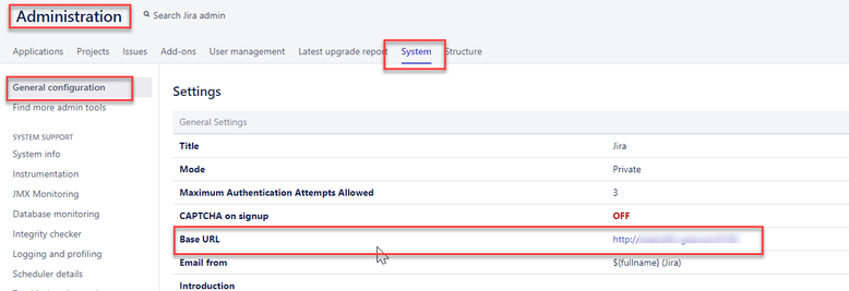

Replace the url with your JIRA base URL:
https://asc.mycompany.net/jira
You can verify and retrieve the JIRA Base URL from Administration --> System --> General Configurations --> Base URL
