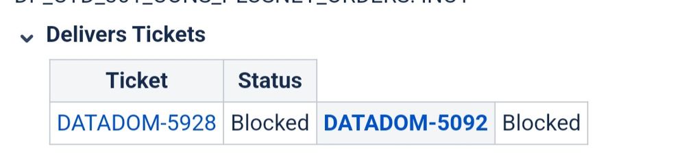

I'm trying to create a table within another field (acceptance criteria) using jira automation to display my linked issues however I can't get each issue to show on a new row.

Alan Alder
July 12, 2024
Thanks @Bill Sheboy  it's now put the record on the same row but different columns. Is there away to get them on different rows instead of columns

Bill Sheboy
July 12, 2024
Oops...missing a newline after the conditional to trigger the new row.  I updated the earlier post.

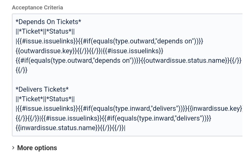

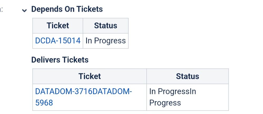

Alan Alder
July 13, 2024
@Bill Sheboy sorry to be a pain I'm still having issues keep getting errors. The delivers is an inward type and the depends on is an outward type.
Bill Sheboy
July 13, 2024
The or() clause needs to wrap around the equals() tests for each type, as the equals() is what performs the test:
{{#if(or(equals(field, valueA), equals(field, valueB)))}}display when true{{/}}
Please note well: you are now mixing link directions in the expression, inward and outward links.  And so the logic to include the type, key, and status will need to be dynamic to use the correct one: inward versus outward.
I encourage you to experiment and get each type, "delivers" and "depends on", working separately and then try combining them.

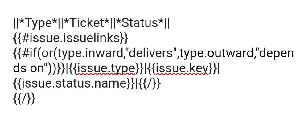

Alan Alder
July 14, 2024
@Bill Sheboy  how do I add the dynamic elements as I'm still getting errors with everything I try
Bill Sheboy
July 14, 2024
Please post the expression you are trying.  That will help to diagnose what is happening.
As an alternative to the dynamic elements, you may instead repeat the conditional blocks inside of the iterator.
{{#issue.issuelinks}}
conditional block to test for "delivers", and add a row
conditional block to test for "depends on", and add a row
This will also handle the case of adding the same issue twice in case it has multiple links to the same issue, but with different types.
