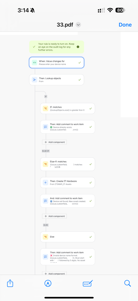

Hi everyone
I’ve created an automation where, when a user creates an issue and enters a device name in a custom field, the automation checks the IT hardware asset sheet for a matching device name.
  • If the device name matches an existing asset, the automation simply adds a comment saying the device name matches and takes no further action.
  • If the device name does not match, the automation creates a new asset record with that device name.
My current challenge is adding a condition to validate the device name format. For example, if the device name entered doesn’t follow the required pattern (like starting with “ABC” followed by digits, e.g., ABC1245), the automation should fail, notify the user that the device name is invalid, and not create a new asset.
I’m struggling to design the correct structure using “If → Else” conditions to make this work properly.
this: is the condition
{{issue.customfield_xxxx.trim.match("^ABS\\d{5}$")}}
would be much grateful for any ideas I can write down the whole structure i have

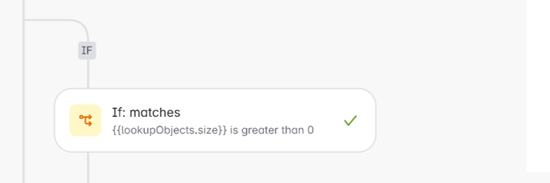

StepActionDetails
TriggerIssue Created or Field ChangedDevice name field
ActionLookup rows/issuesFilter: deviceName = {{issue.fields.deviceName}}
Condition (if/else)If lookup count > 0Device exists → Do nothing or comment
ElseCreate assetUse device name from issue
 Add comment"New asset created with name: ..."

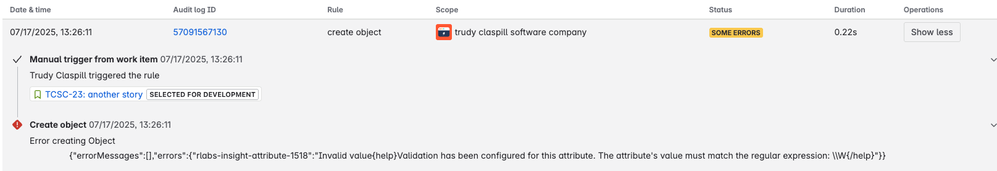

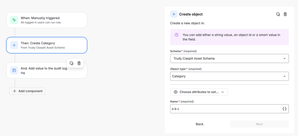

Trudy Claspill
July 17, 2025
@arielei
That won't work.
When the validation fails and the object can't be created, that will cause an error to occur in the rule and none of the steps after that will be executed.Screenshot 2025-07-17 at 1.27.58 PM.pngScreenshot 2025-07-17 at 1.27.43 PM.png
Like John Funk likes this

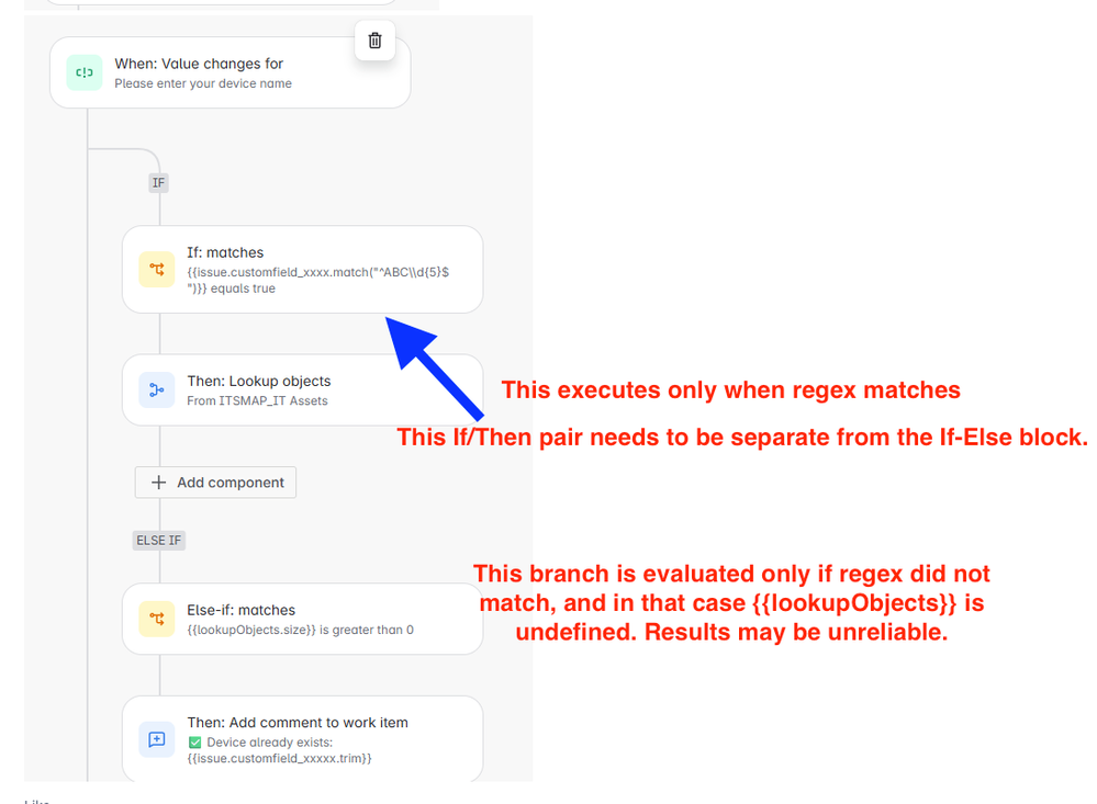

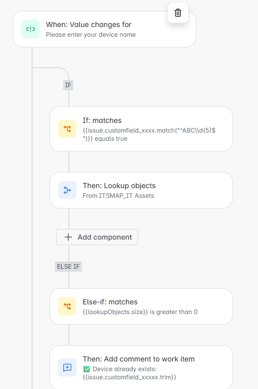

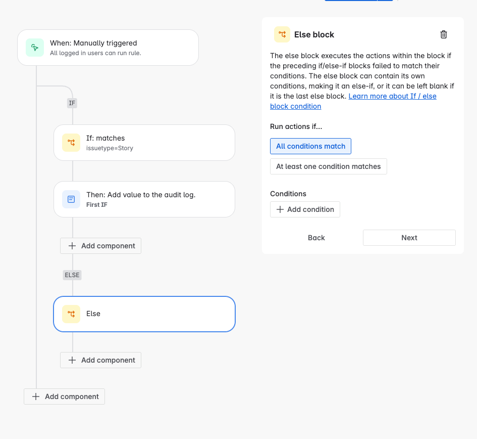

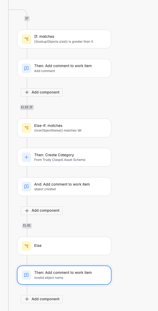

Trudy Claspill
July 17, 2025
Hello @Shi
I recommend that you use an Else-if to validate the name provided in the issue against a regex. If the name is acceptable, execute the Create Object action. Then the final Else handles reporting that the name was invalid.

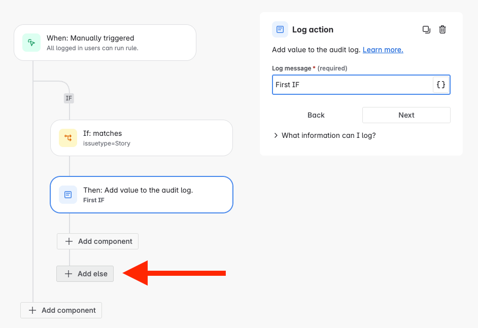

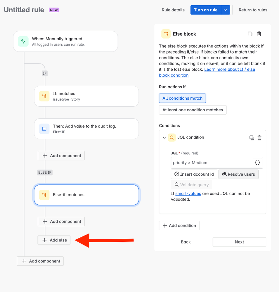

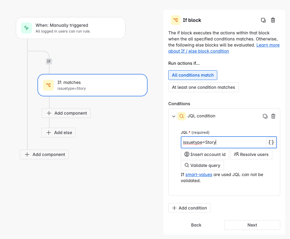

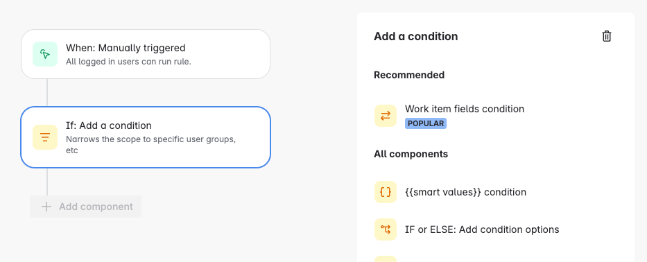

Shi
July 17, 2025

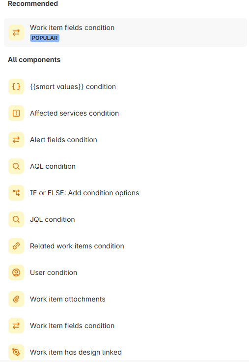

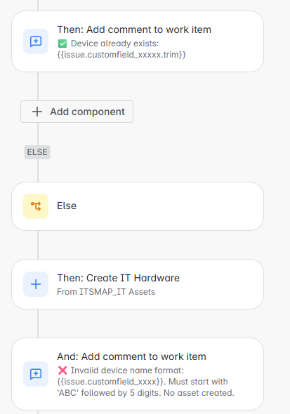

That’s strange I am not able to see more than one else in an IF branch - so using IF or else
gives me only one else and this is my main problem I wonder if this is the license am using?
Trudy Claspill
July 17, 2025
No, there is no difference in this functionality based on the license.
Can you provide a screen image of what you see?
