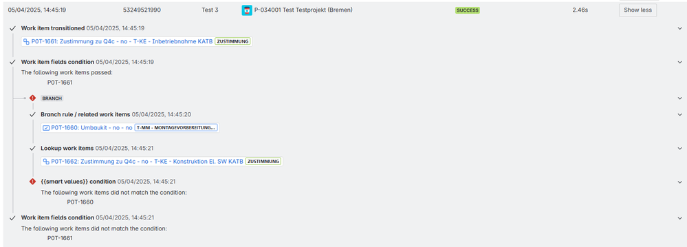

Please show an image of the audit log details, with all of the areas expanded, to show which rule steps happened.
As written, your rule will stop when any condition is not met. Have you confirmed the Status values you are using in the JQL conditions for each subtask type are correct?
Hello @Bill Sheboy
I just made another attempt and then had a look on the audit log.
However, this information does not gives any insight into the problem. It seems that this automation is not running at all, although it is enabled.
The entry you show is for a rule edit, not an execution.
Please transition an issue to trigger the rule, check the results, and then post the image of the audit log details showing the rule execution.

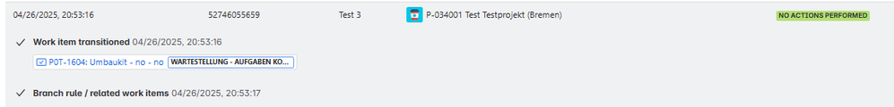

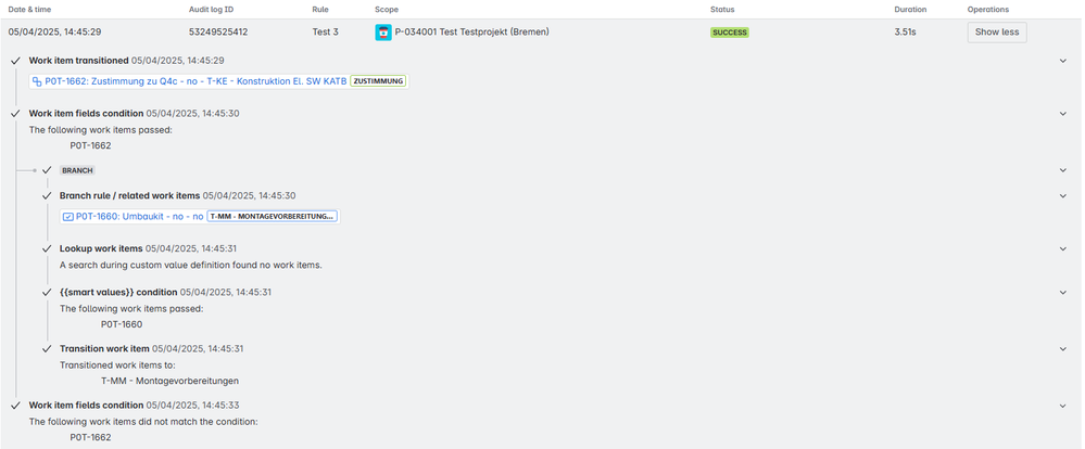

Please expand the audit log details to show everything by expanding the arrows at the right side of the log. That will show what else happened as the current image just stops at the start of the branching.
It has already been completely expanded; no arrow or possibility to expand with the branching rule:
Based on what you show, the trigger issue POT-1604 has no parent issue.
I suspect you only want this rule to run when the trigger issue is one of your subtask types, and so after the trigger add an Issue Fields Condition to check that the Issue Type is one of your types:

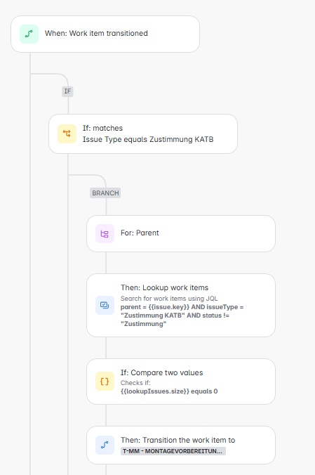

Hello @Bill Sheboy ,
great .... after all it works with 1 sub-task type.
After that I added another condition with another issue type, branched it to the parent, updated jql.
Test 1:
After transitioning all items of the first sub-tasks type (not the second issue type), parent already transitions
Test 2:
Transitioning all items of the second sub-task typ, parent does not transition;
only after transitioning the first sub-task type
That sounds correct, based on the rule you show now. Do you agree?

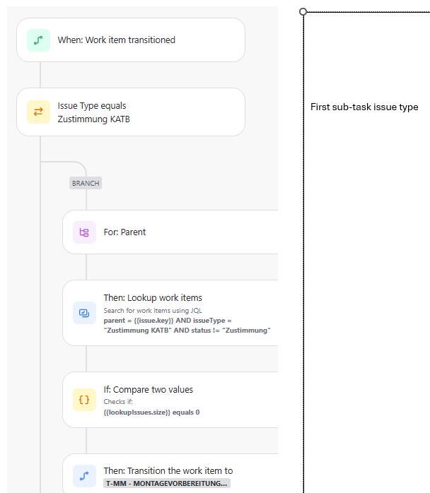

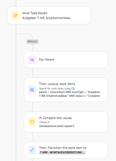

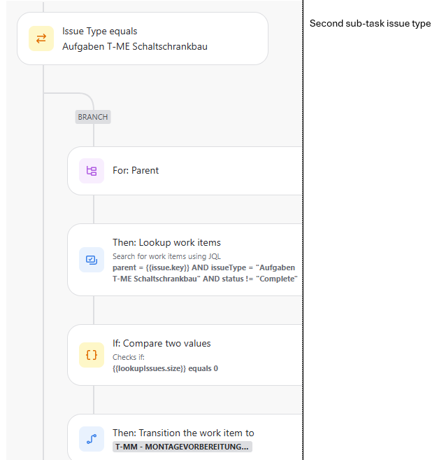

what I wanted to say is, that I added another condition after the trigger for a second sub-task type.
But it doesn't work for the second subtask-type, only for the first one.
Test-scenario:
new workitem only with 2 sub-tasks of second type, both in status "complete", but parent does not transition.

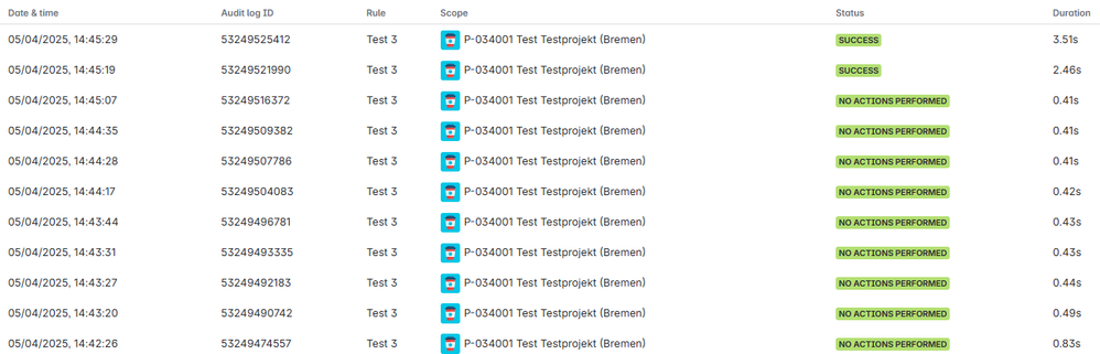

The audit log shows No actions performed
Please post an image of your current complete rule and of the audit log details from that last rule execution (with all of the details expanded). Thanks!
please receive as requested.
Log ID 53249509382 is identical to the following 7 logs, therefore I included it here only once.

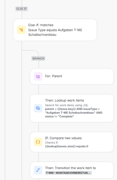

Thanks for the rule image as that explains the problem:
When a condition is not met, a rule stops processing. When you want multiple different conditions to be checked AND the rule to continue for each, please use the if / else block with the conditions.
For example:
With your current rule, you may add the if / else after the trigger and then drag-and-drop the branches inside to adjust the rule.
Hello @Bill Sheboy
Thanks for your comprehensive reply.
I implemented it as you described, but again parent transitions after workitems of the first sub-task issuetype are in the status defined.

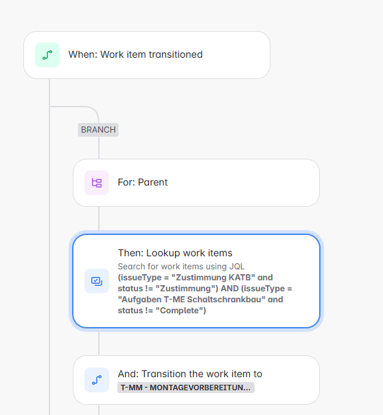

When you return, let's consider how to combine the conditions as you want BOTH of the subtask type checks to succeed. That may be done by combining the tests in a single JQL expression.
The JQL for the lookup could be this. Please review and update it as needed.
parent = {{issue.key}}
AND (
(issueType = "Zustimmung KATB" and status != "Zustimmung")
OR (issueType = "Aufgaben T-ME Schaltschrankbau" and status != "Complete")

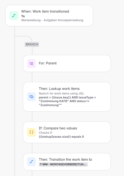

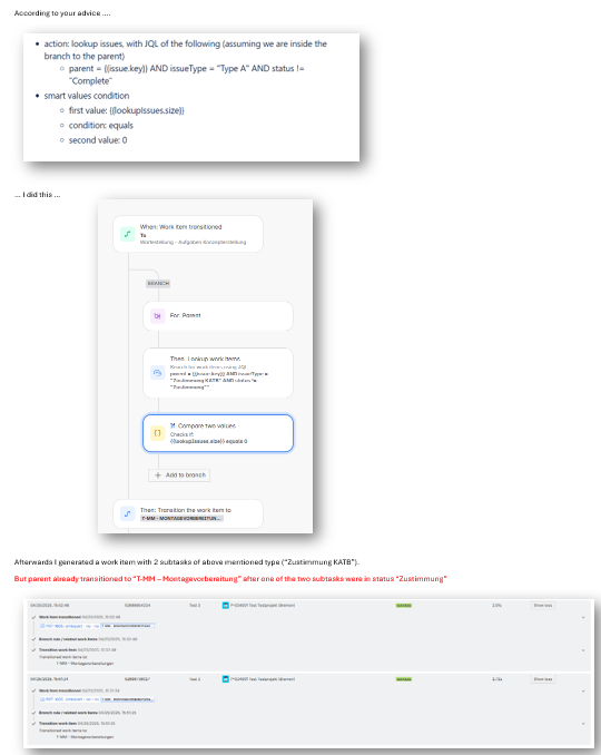

Hello @Bill Sheboy
thanks for this new attempt.
I just updated automation and the JQL for the lookup according your recommendation:
AND (
But again .... after first subtask-type is in status "Zustimmung" parent transioned into next status although second subtask type was not in status "complete".
After that I changed JQL for look up (AND instead of OR):
(issueType = "Zustimmung KATB" and status != "Zustimmung") AND (issueType = "Aufgaben T-ME Schaltschrankbau" and status != "Complete")
But just the same.
Please review my earlier suggestion as your rule is missing the condition after the lookup and before the transition:
Hello @Bill Sheboy
now it is working as expected!!
I only must add the other subtask types to the Lookup work items.
Thank you again for your expertise and patience!

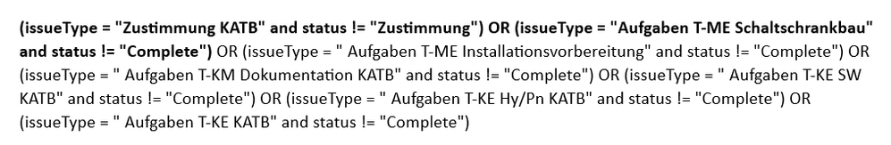

Today I extended the lookup with the missing 4 subtask types and again it does not work. No other changes made.
With the bold part it worked, after the extension it doesn't.
Could you please advise if there is anything wrong with this termin (I checked correct writing of subtask-types) or is there any quantative restriction I have to keep in mind?
I see some spaces before your status names for the updated JQL. Have you tried removing those spaces?
As a tip: I recommend testing JQL outside of a rule first, perhaps with example work items / issues. Once it works as expected, copy it into a rule for further testing.
Just to confirm, did you remove the extra spaces from the JQL in the rule?
