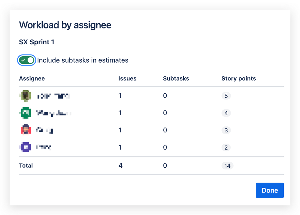

Yes, the current "Workload by assignee" report doesn't include time estimates, which is not a bug. What you're expecting is a new function point to Jira product. I think you could raise a ticket to Atlassian support to request this feature.

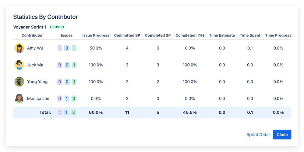

If this is key function to your team, maybe you could have a try of Jira Apps like Sprint Reviewer Pro as follows:

On top of what @YY Brother said, here's a feature suggestion that I think, fits what you've described: JSWCLOUD-15991: Take into Account sub-tasks when calculating the Workload by Assignee
