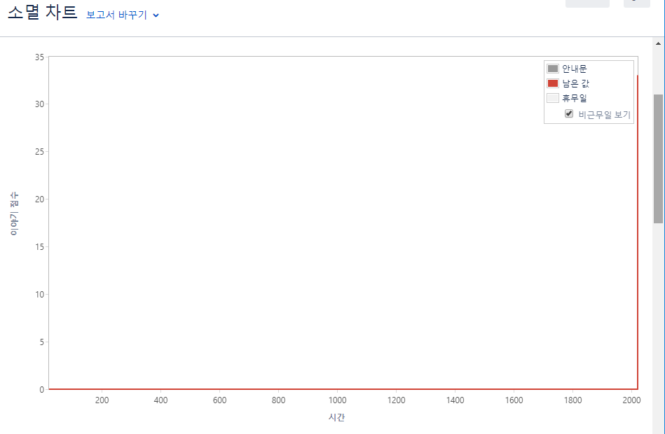

Hi, Team
I am using 'Jira Software version 7.12.3'.
But the horizontal display value of the 'burndown chart' is strange.
It is displayed as below.
How do I make it look as below?
Alex.

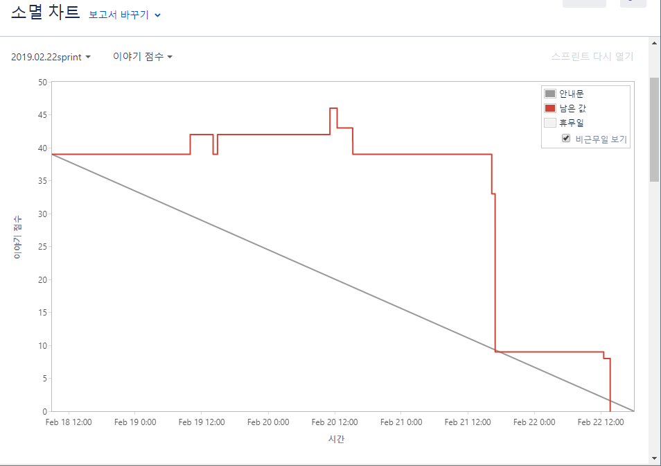

Hi Alex,
The time scale looks very strange to me in your first screenshot.  It's almost as if the time scale there is in hours of a single day.  In the screenshot below, you can see that the time scales from Feb 18 - Feb 22, a period of 5 days.
Since this specific report functions off a sprint, it is possible that you created a sprint on the same day as adding all these issues, which would cause that red line to jump right at the very end if no work as been done to any of these issues yet.
However over the course of say 2-5 days, should some of those issues get completed or more issues get added to the sprint, I would expect to see much more in the way of data points here.
Considering you posted this Monday and today is Friday here, I'm interested to see if this has changed at all since then.
Please let me know.
Andy

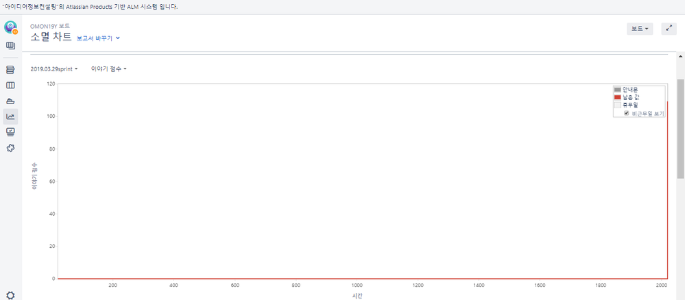

alex seol March 18, 2019
Hi Andy
Thank you for your attention.

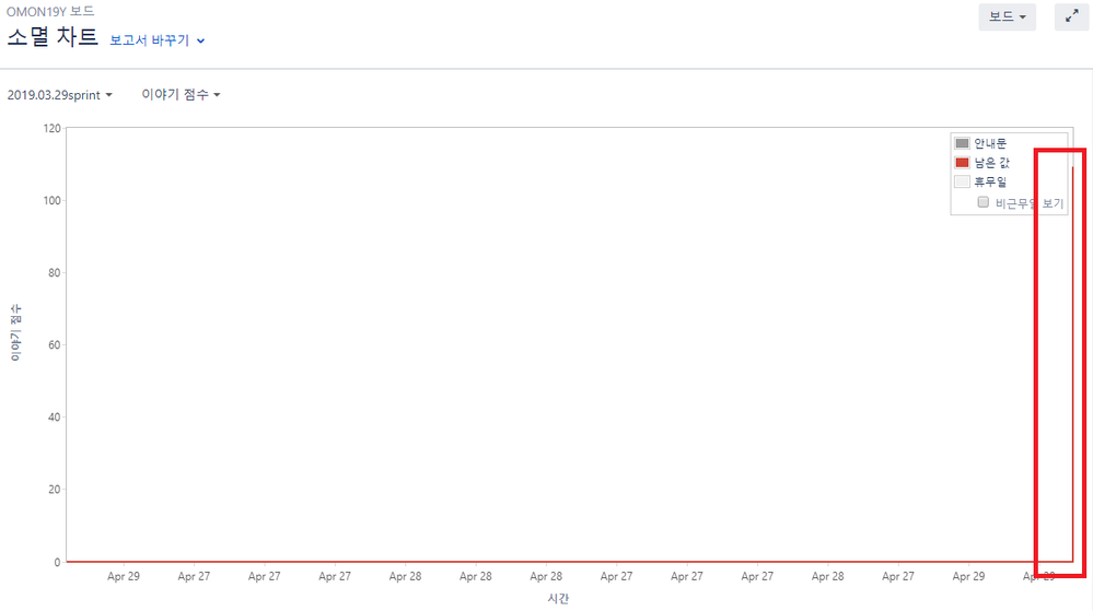

However, 'burndown chart' did not change at all. Below is an image of Capture 'burndown chart'.
Can not change the horizontal row value of the 'burndown chart'?

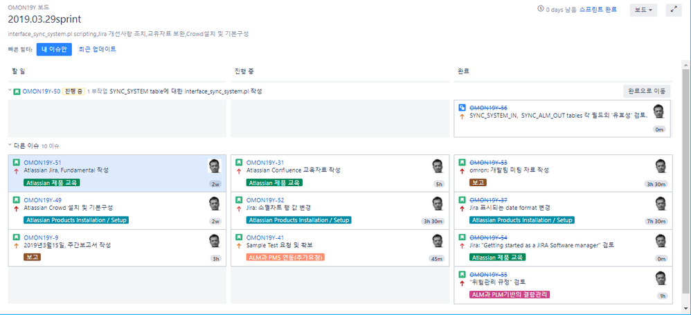

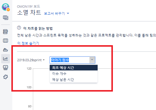

Below is the 'sprint board screen'. There are clearly finished issues.
However, it is not displayed in the 'burndown chart'.
I changed the red part below to various values. However, the 'burndown chart' has not changed.
I am looking at documents related to the 'burndown chart'. But I really do not know. Waiting for your help.

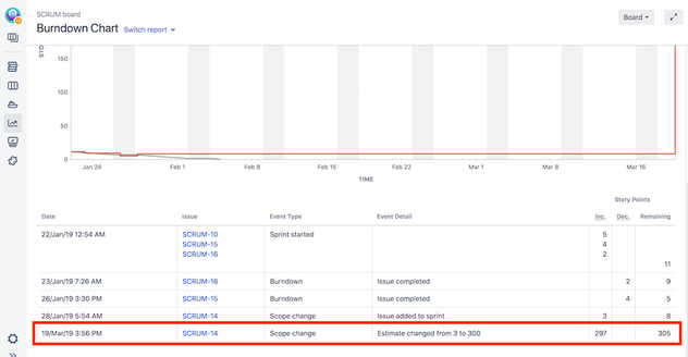

I think what has happened here is that after the sprint has been started, that some large estimate was added to an issue in the sprint or additional large estimated items were added to the sprint.   In my own system I tested this against an open sprint.  I went into the active sprint and changed the estimate value for one issue from 3 to 300.  The field warned me before doing this that it would result in a scope change.
If you return to the report, it does document that below the graph as such:
I think this is what you are seeing, something was changed during the active sprint in regards to an estimation increase.

alex seol March 24, 2019
Hi, Andy.
I have completed a number of issues with your guidelines.
Result, The burndown chart has changed slightly.
Vertical red line length is slightly shorter.

Andy Heinzer
March 26, 2019
Hi Alex,
There is something else wrong here that I could not see until your most recent screenshot.  The bottom axis is for time on that graph.  However your values are not consistent in that graph.   They should only progress in a forward manner as the line moves from left to right.  However your dates appear to start with April 29, then go to April 27 and 28, before going to back to April 27th.
Unless this sprint has been set to run for multiple years, which would be an extreme interval to run a sprint, I think there might be something else wrong here in regards to the way that Jira is currently setup to use dates in your system.   If my suspicion is correct this could cause the problems you have been seeing in regards to way this graph is trying to chart this data.

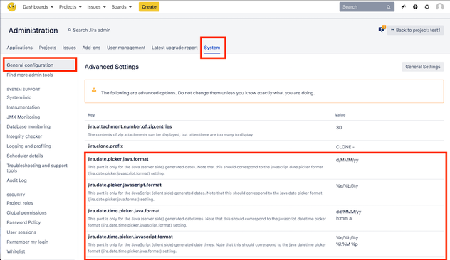

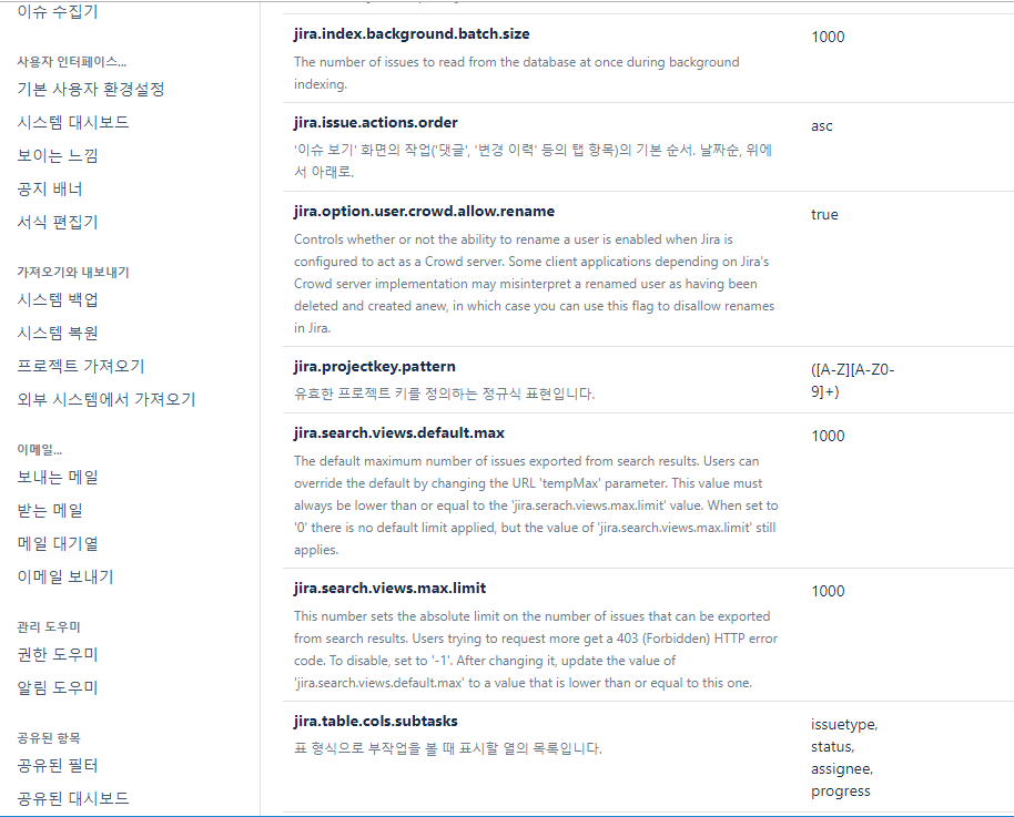

Please go to the Cog Icon -> System -> Advanced Settings.  Please take a screenshot of your date/time settings here like this one.
I am interested to learn if perhaps these values have been adjusted for your region or locale which in turn might be a factor in the way these kinds of graphs are rendered in your environment.

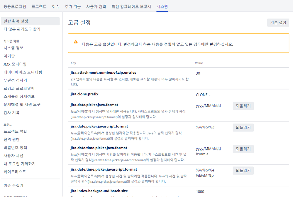

alex seol March 27, 2019
Hi, Andy.
We have changed the following to match the date display to 'region locale'.  YYYY/MMM/dd (below)
Is there a problem?

Andy Heinzer
April 1, 2019
Hi Alex,
I recall there being a few reported bugs in regards to the way some reports work in Jira and Jira Software when the system is configured like yours to use a different date format.   One of these is https://jira.atlassian.com/browse/JSWSERVER-7238 However I'm not certain yet if this is exactly what you are seeing here.
To test this, I would be interested to see if clicking the 'Revert' button for those date settings under the Advanced Settings section and then re-running the reports might help to show that report correctly.   If so, then I think we can safely say that there is a limitation or bug in regards to the way the burndown report works to display this data.   It is possible there are other reports that might not be rendering correctly give your date and date/time settings in Jira right now.
