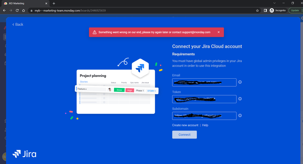

I am getting an error while trying to integrate Jira with monday.com. Have tried Chrome (even in incognito mode) and MS Edge but no luck. Find attached the screenshot of the error message. Jira Global Admin's credential is used for this integration using the correct Jira API token and Jira Subdomain.

Hello @Daniel Eads , thanks a lot for your response. I have updated my Chrome and relaunched and tried again but no luck. As per your advice, I tried sending a GET message using https://jkdmarketing.atlassian.net/rest/api/3/myself API endpoint and got the below response. Could you please let me know the possible issue here from the error message below? Does it mean that the user name (email address) used for doing this integration does not have the required permission (not a Jira Global admin)?

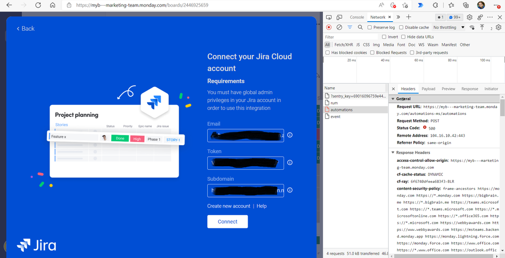

Mohajit Acharya
April 3, 2022
Many thanks, Daniel for your detailed analysis. I have tried again by creating a new token but no luck. But this time I have taken the screenshot of the console log which I am pasting below. I have written to monday.com support as well.
