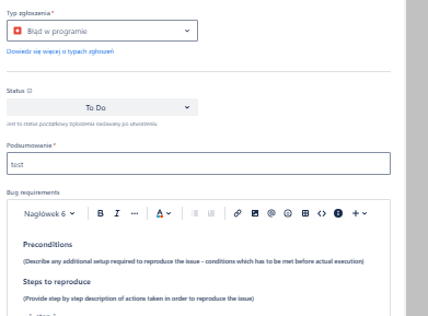

We have a problem with custom field called 'Bug requirements'. It is formatted in Wiki style and have predefined value, it is linked only with screen for Bug issue type. Everything worked for a few days, but now for some users when they create a bug whole custom field with predefined value dissapear a second after they choose a issue type.
The problem exist on the project where we are using Xray - I am not sure if this may cause the issue.

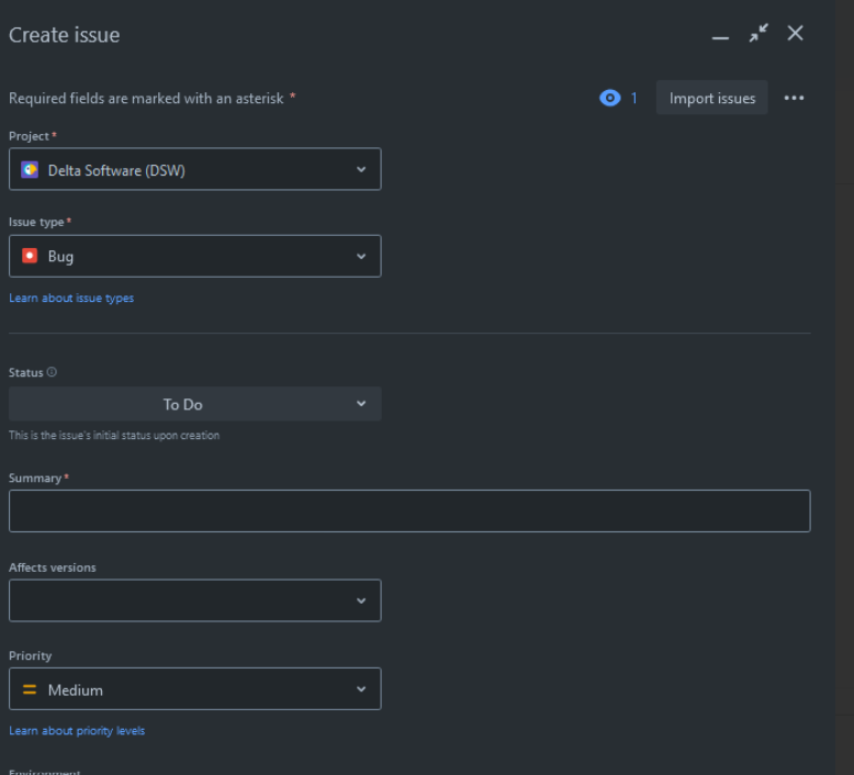

And for those where it is not working
The difference I noticed beetwen users is that, for those where it is not working additional field 'Affected versions' is added.
As a workaround I added custom field 'Bug requirements' on different card in screen, but I would like to know what is causing the issue on the General card view?

Also, the fact that the Affects Version/s field shows up on the screen sometimes almost indicates that, for that project, you're using a different screen.

Are you sure that both screens are from the same project? I'm asking because I don't see project field on first screen.
