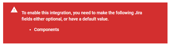

I got the error says "To enable this integration, you need to make the following Jira fields either optional, or have a default value."
We have a required custom filed (component) but no default value and we don't want to set a default value.

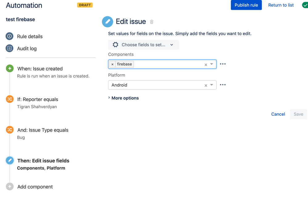

I know this one is a little old and I came across it and we solved it with a little automation. I have a triggered automation when the ticket comes in from Firebase that sets the value of the field so it can proceed. In your case you could set the value and then use a second automation to unset the value. A little bit of a hack, but it should get you moving forward if you have not yet.
Sure. What we did was set up an automation that triggers when an issue is created to look for the user that we set up with Firebase integration (that user only creates issues from Firebase) ... then set an action when true to set the fields you need to have a value but not a default. The real trick is to get the trigger to run properly then just edit the field and put in the value you want.

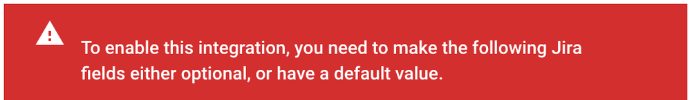

When I try to set up the integration with Jira in Firebase, I fill all the fields needed (username, Jira project link, Token) and it shows the following error :

Ok. thank you, one more question, Can you check the rightness of the screenshot I've sent you?
Looks reasonable. One thing we did was to use a non-regular user to link in with firebase, that way when triggering on the user, it did not impact a regular user. In your situation, by that rule, any time you create an issue of type bug, the issue will be automatically update Component and Platform.

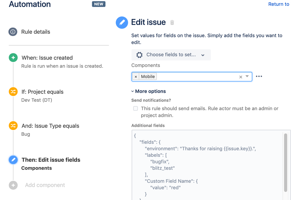

Here is what our simple automation looks like.

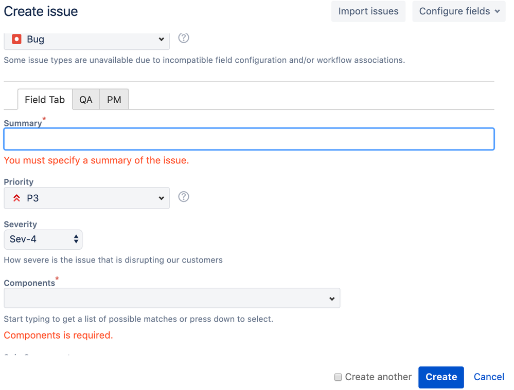

I get the same error message as @Yannick Biet and @Kelly Wang .Thanks @Tigran Shahverdyan and @Mathew Sommers for the suggestion to use Automation. But wouldn't the automation only execute AFTER the Jira ticket is created and not DURING? When we create a Jira ticket, the "Component" field must be filled in before it can be created. I did create an Automation rule to update the "Component" field to my desired option and it does update, but only after I select a random Component. See screenshots. Any help is appreciated.

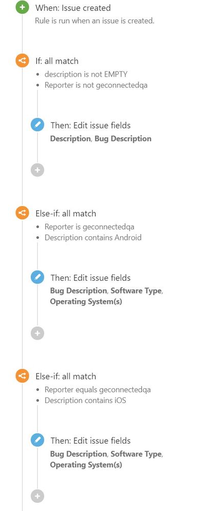

Here is the Automation I created which does update the Component field after the ticket is created
