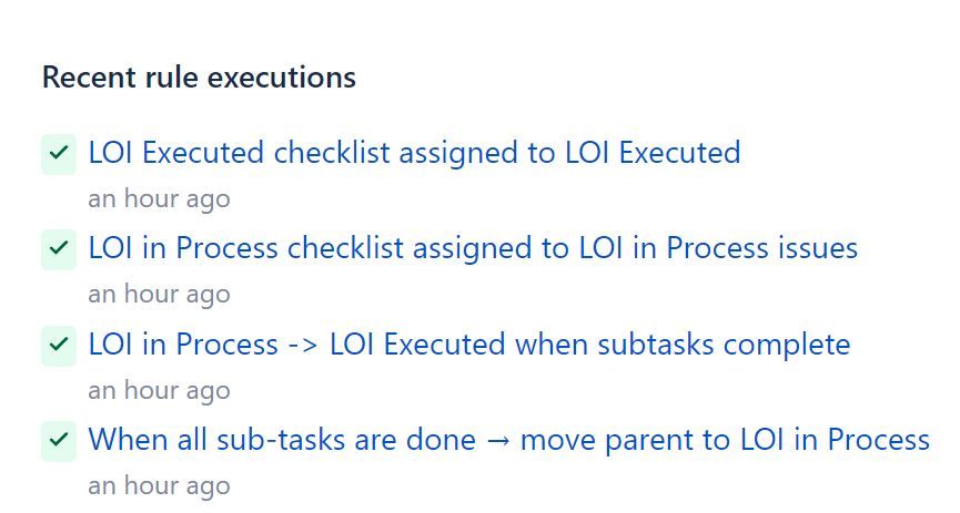

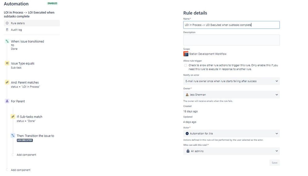

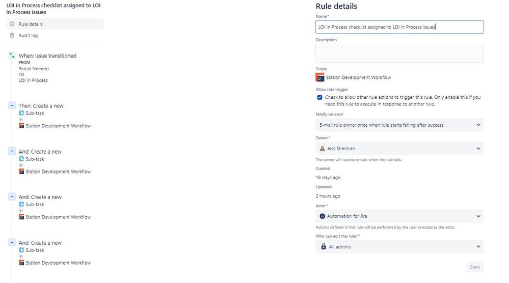

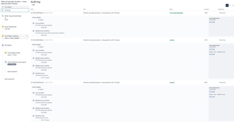

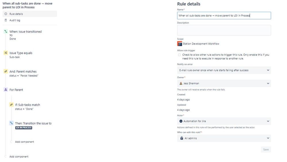

Hi Bill,
So here's the audit log of the Parent issue. If you notice it transitioned twice and then assigned subtasks twice instead of transition -> subtasks -> transition -> subtasks. I've also attached screenshots of the two transition rules and the first subtask automation. Hopefully this helps to clarify the issue. I'm still pretty new to this tool, but hit the ground running! Appreciate the help.
Jess Sherman
October 10, 2022

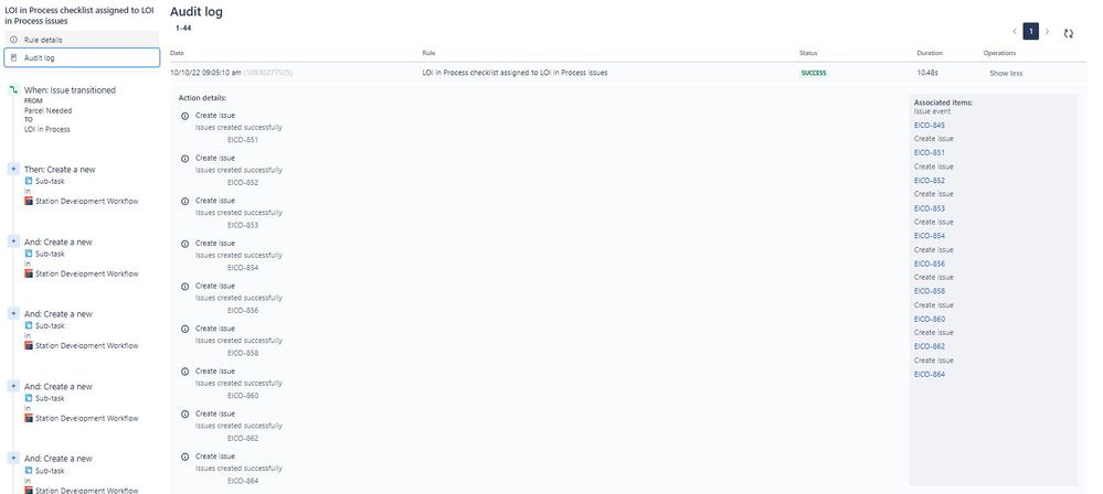

Jess Sherman
October 10, 2022
LOI Executed Audit Log.JPGTransition to LOI in process Audit log.JPGLOI in process audit log.JPG

Thanks for those details, as they explain what I believe is happening:
Both rules to transition the parent are being trigged when the subtask move to done, and it is a timing issue of exactly when one updates the parent...and then the other rule updates it again to "LOI Executed".  Further still...it is possible the third rule which creates the additional subtasks may be running at the same time!
To break this link, you may need more of a redesign...What if you created the additional subtasks in the first rule before you transition the parent to "LOI In Progress" and eliminate that 3rd rule?  That will reduce the chances of both rules proceeding past the condition on the parent's status.
