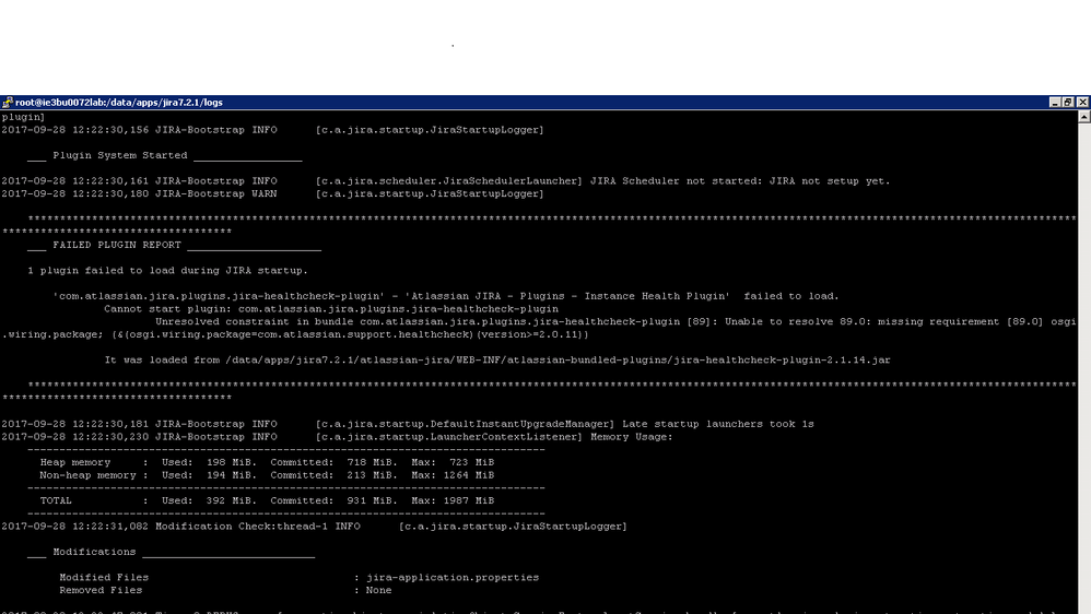

I done the installation and i went through catalina.out log file. It was showing that failed plugin report . Please find the below screenshot. this health plugin become issue for starting the jira . can you help me to fix this

Can you please post the section of the logs where the plugins are loading and sections of the log that are showing error.

This is a known issue in 7.2.1. You can find information about it here: https://jira.atlassian.com/browse/JRASERVER-62459?src=confmacro
