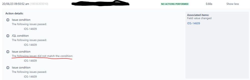

Are you sure the rule is not running, or is the rule running but encountering a condition that does not pass? Check the Audit Log to determine if the rule is running for the clone issue. You can also click on the Rule Executions field in the Details panel of the individual issue. That will pop open a panel that shows you a history of the rules that have executed against that issue.

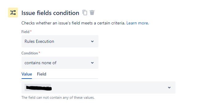

The cloned task has a label that exists that is created by the automation. If the label does not exist the automation can run. I removed the label and try to run the automation but it does not run. The audit log says it failed because the label exists, but the label is not there.
2nd snippet: has the label that if exists will not let the sub-tasks be created. But 3rd picture shows the issue we are trying to run execution of automation: the label field is empty.
Will keep double checking this.
I just realized it is not a labels
It is looking for a rules execution in the cloned items that equals TeamTasks as per snippet 2 (middle) I was reading too quickly.

Someone created a new labels based custom field called RulesExecutions
I made it visible on all issues and now people just make sure cloned issues have the label deleted before running the automation.
