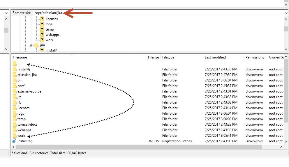

Here is a screenshot of what I'm talking about. These are all the subfolders in the jira directory before I tried to do the upgrade.

Yes this screenshot shows the steps that I go through to do an upgrade of either jira or confluence but in the past this has always worked fine. This time the upgrade physically deleted all the folders below the jira or confluence folder, as I indicated previuosly.

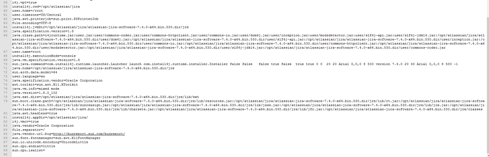

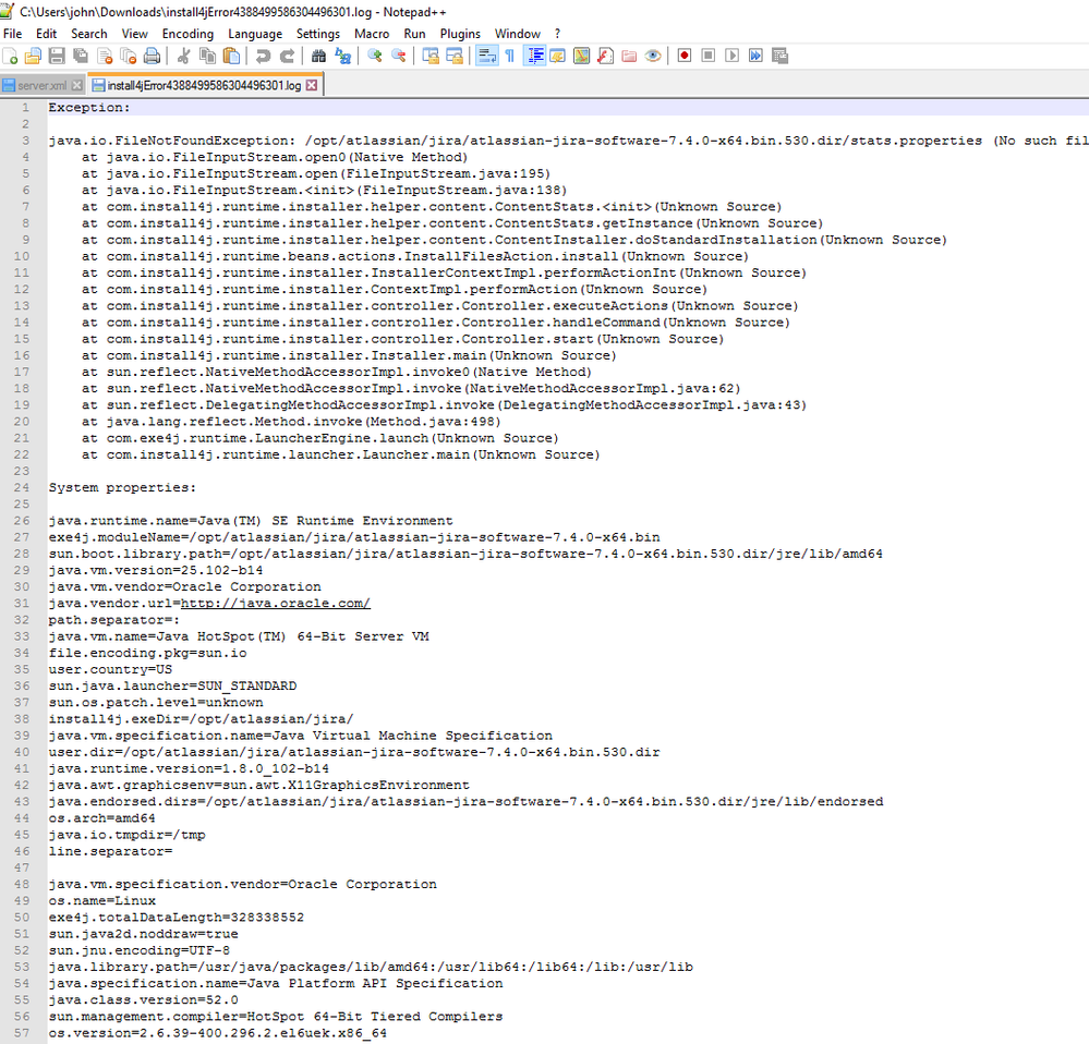

OK I just tried the jira upgrade again, using version 7.4.0 rather than 7.4.1 which showed to be the latest versionfor download. The upgrade failed again in the same way, deleting all the folders within the jira application folder. Here are screenshots of the error log that was created-
Is the installer deleting itself or is this a known IO error? Have you tried to make a clean install in another folder? From which version are you upgrading by the way?
I believe that the installer does delete the existing directory but it is supposed to replace it with the new one and it appears that the errors are causing that part of the install to fail. Currently we are running version 7.2.6 of jira and have been trying to upgrade to the latest; version 7.4.1
