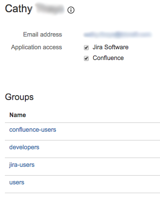

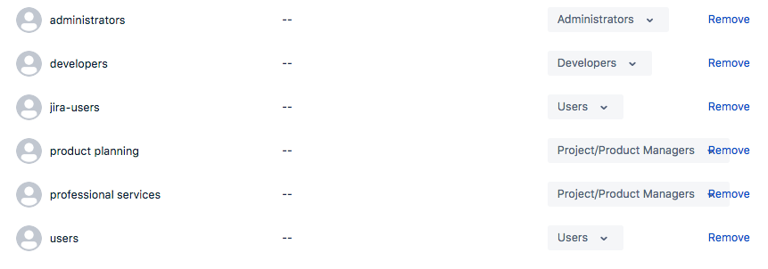

Desired: We only want Project/Product Managers (as designated via project permissions group) closing issues. Developers (as designated via project permissions group) can transition issues to all other states in the workflow except they cannot close them.
Problem: The Developers can close issues even though their 'permissions group' in the project does not have permission. When I use the Permissions Helper, it reports that they don't have permission, even though they can actually do it.
Other information: We have 1 board with 4 projects on it. All four projects have identical configurations when you look at the Summary page for them.
See 5 screenshots below:
Thank you in advance.
