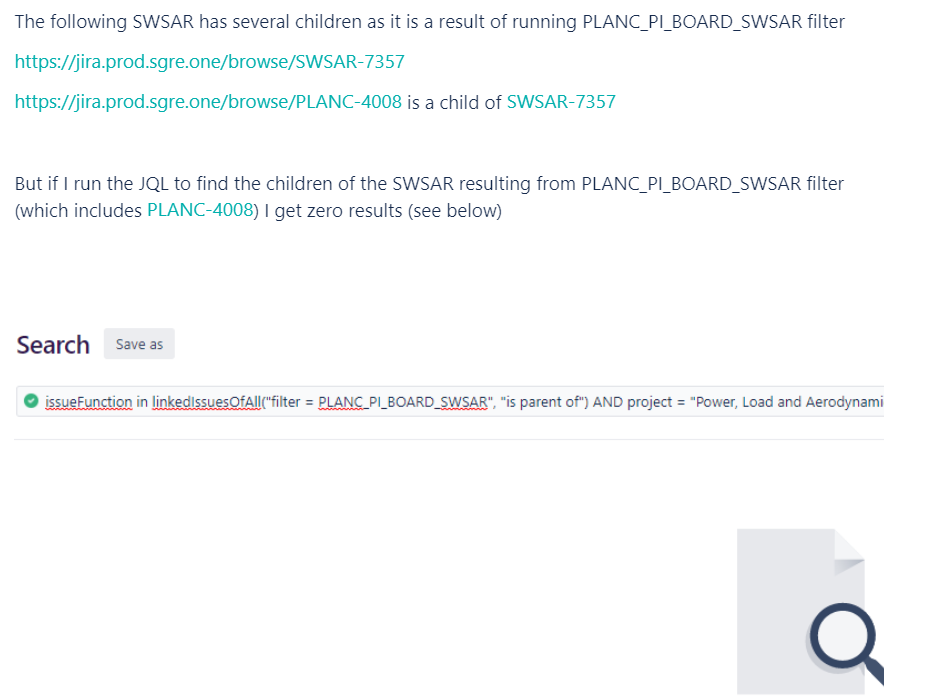

The below query does not return anything ,Kindly anyone help me to find the solution
issueFunction in linkedIssuesOfAll("filter = PLANC_PI_BOARD_SWSAR", "is parent of") AND project = "Power, Load and Aerodynamic Noise Control"
Hello @Swati Mathapati
Using "filter = PLANC_PI_BOARD_SWAR" and "is parent of" indicates you are trying to find all issues returned by the filter PLANC_PI_BOARD_SWAR that have a link "is parent of" to another issue.
This is further constrained in that the issue returned must also be in the project "Power, Load and Aerodynamic Noise Control"
What are the details of the filter PLANC_PI_BOARD_SWAR?
Can you provide a screen image of an issue that you believe meets the conditions of your JQL?
linkedIssuesOfAll is a function provided by the Adaptavist ScriptRunner app. Can you tell us which version of that app you have? You may need to consult with your Jira Administrator to get that information. Additionally can you tell us the version of Jira that you have?

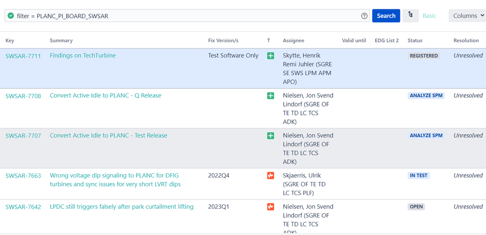

The version of the app we are using is Version: 6.58.0
The screenshot of the filter is attached below
That image does not tell me the details of the criteria in the filter named "PLANC_PI_BOARD_SWSAR". It only shows me the results of the filter.
You need to go to the list of all filters and find the one named "PLANC_PI_BOARD_SWSAR" and show us the criteria it contains.
Also, what version of Jira are you using?
I am not able to offer additional advice without having the details of the filter named PLANC_PI_BOARD_SWSAR.
I suspect that the reason you are not seeing any results is that filter does not include issues that are in the project "Power, Load and Aerodynamic Noise Control", and that is a criteria in the query where you are using the PLANC_PI_BOARD_SWSAR filter
I am checking with the user for an example that passes the entire query. I will get back to you.

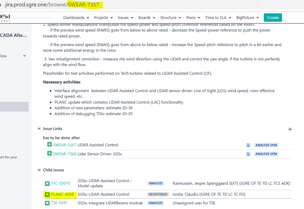

Can you show us an image of SWSAR-7357 showing the part of the screen that shows the linked issues and including the PLANC-4008 issue?

Using just this much of the query:
issueFunction in linkedIssuesOfAll("issue = PLANC-4008", "is parent of")...do you get a list of all the children of SWSAR-7375?
We have tested with some other projects as well and understood that its a problem with Issue linking ("is parent of", "is child of").
Could you please help us to know what we need to use for parent-child relationship?
