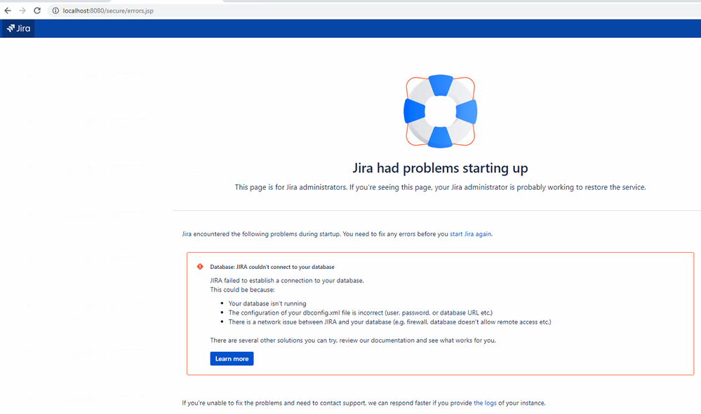

A few days ago our locally installed Jira on Windows Server 64 bit stopped functioning (can't load the site). The last log that was written has the error: java.util.zip.zipexception: error in opening zip file.
I have backed up our old database, uninstalled and deleted Jira's folder then reinstalled Jira. If Jira uses the newly created database, Jira will load and try to set everything up normally. If i replace the new empty database with our original database, I get the same java error as before.

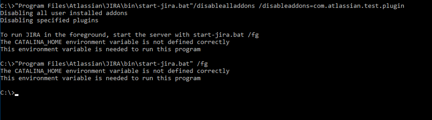

I have attempted to launch Jira with all of of the plugins disabled as per the troubleshooting instructions but then i get in command prompt "The Catalina_Home environment is not defined correctly".
I have found this link that says i need to set Catalina_Home but doesn't really explain what to do other than "Edit setenv.sh and set your CATALINA_HOME accordingly.". https://community.atlassian.com/t5/Off-topic-questions/The-CATALINA-HOME-environment-variable-is-not-defined-correctly/qaq-p/398487
This is the point where I am stuck. Am I on the right path? Seems like an odd thing to just stop functioning one day.

I have updated dbconfig.xml to use my admin credentials but still no luck. I get the same page error as before.
I have stopped and started the server.
I am using the the localhost:8080 to access the database which is on the local C drive so there shouldn't be any firewall issues.
Is there anything else i should try?

The next is to go back to the "CATALINA_HOME" environment variable is not set correctly. i.e is the path the same with the installation directory?
and 'CATALINA_HOME" should be the full path for the JIRA installation directory
it should look like this C:\Program Files\Atlassian\JIRA"
so make sure it is the same and then start Jira service. You can also check environment variables in Windows.

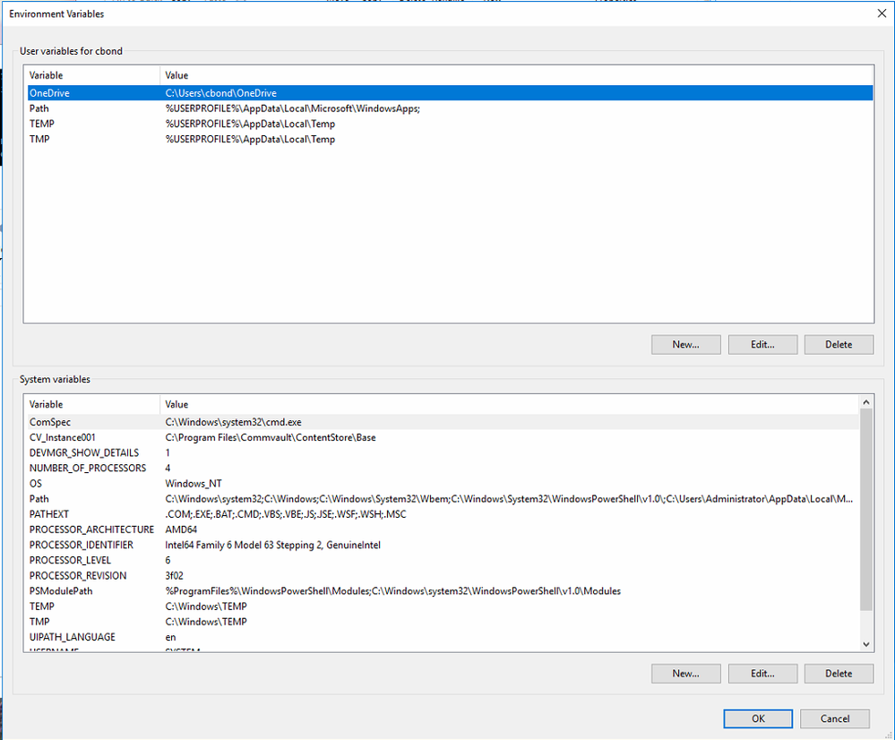

Yes could you scroll down to check whether there is JAVA_HOME or JRE_HOME set in the system variables.
for the setenv.bat " it says JAVA_HOME=C:\Program Files\Atlassian\JIRA\jre\
because i think you install JIRA via the atlassxx.bin file so JAVA is packed together
JIRA need java_home/jre_home to be set in the environment variables for it to run.
check the right path to verify whether the path C:\Program Files\Atlassian\JIRA\jre\ exist and scroll down to check whether there is JAVA_HOME or JRE_HOME set in the system variables. if you don't have it then add new
variable name : JAVA_HOME
variable value: C:\Program Files\Atlassian\JIRA\jre\
if the path exist then edit to verify the path is correct.
Setting the JAVA_HOME Variable in Windows
Please try and give feed back.

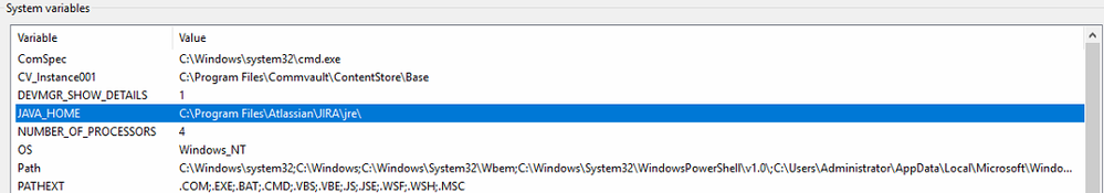

I have made the change in Enviorment Variables, stopped and started the Jira service, but am still having the same "Jira had problems starting" page.

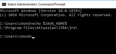

@Cory Bond Does this path truly exist ? if yes what do you get when you
from the command prompt type
echo %JAVA_HOME%you should get the path, if not try restart host

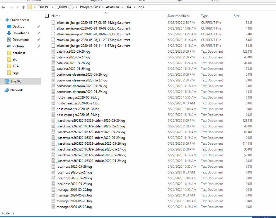

then check again if it doesn't work then please provide logs in <jira_home_folder>/logs/
@Cory Bond The path is not updated please see my previous comment
Try restart the whole jira server(machine)
Try again check java home if it appear then restart service (Jira)
If it doesn't work I need to see logs in logs in <jira_home_folder>/logs/
Also show the service.bat file
I have restarted the VM, now the Java_Home shows up. However still no luck.
What in the logs do you need?

@Cory Bond There should be logs in this folder C:\Program Files\Atlassian\Application Data\JIRA\log\atlassian-jira.log
Please provide this logs, there could be valuable info there
Mo

This could be because:
- Your database isn't running
- The configuration of your dbconfig.xml file is incorrect (user, password, or database URL etc.)
- There is a network issue between JIRA and your database (e.g. firewall, database doesn't allow remote access etc.)
There are several other solutions you can try, review our documentation and see what works for you.

@Cory Bond After going through the logs i found this.
[c.a.j.config.database.SystemDatabaseConfigurationLoader] Reading database configuration from C:\Program Files\Atlassian\Application Data\JIRA\dbconfig.xml
2020-05-29 11:17:04,194-0500 JIRA-Bootstrap INFO [c.a.j.config.database.DatabaseConfigHandler] Trying to get encrypted password from xml and decrypt it
2020-05-29 11:17:04,209-0500 JIRA-Bootstrap INFO [c.a.j.config.database.DatabaseConfigHandler] Database password decryption not performed.
2020-05-29 11:17:04,537-0500 JIRA-Bootstrap ERROR [c.a.config.bootstrap.DefaultAtlassianBootstrapManager] Could not successfully test your database:
org.h2.jdbc.JdbcSQLException: File corrupted while reading record: "C:/Program Files/Atlassian/Application Data/JIRA/database/h2db.mv.db". Possible solution: use the recovery tool [90030-185]
It is clear that the H2.db (database) file is corrupted. I have not used the recovery tool before there is an official documentation from the site. Using the Recover Tool
