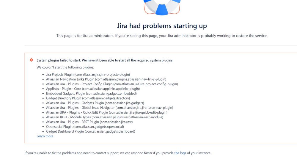

I am practising API's on ocalhost:8080 but today jira start up failed.
Clicked on start-jira where the tomcat window closed quickly and hence executed 'Start-jira.bat /fg ' from command prompt after which I see the below error in my browser on hitting localhost:8080 . Please advise.
We couldn't start the following plugins:
Many reasons can cause that issue. Please take a look to the following troubleshooting article https://confluence.atlassian.com/jirakb/troubleshoot-a-jira-server-startup-failed-error-394464512.html#:~:text=It%20is%20possible%20the%20plugin,application%20instance%20can%20get%20corrupted.

Thank you.
I followed the Resolution 1 in the below URL:
https://community.atlassian.com/t5/Jira-questions/jira-startup-failed/qaq-p/1215226
Backed-up .bundled-plugins and .osgi-plugins , then deleted them, cleared temp and restarted service and it was successful.
