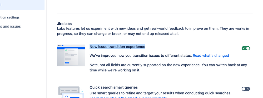

Hello James, Good day. As this screen works fine if you drag and drop the issue between columns in the board, this confirms permission is good. Are you noticing any error when you try from issue view ?
Also try to disable "New issue transition experience" and check the status.
https://xxxxxx.atlassian.net/jira/settings/personal/general
