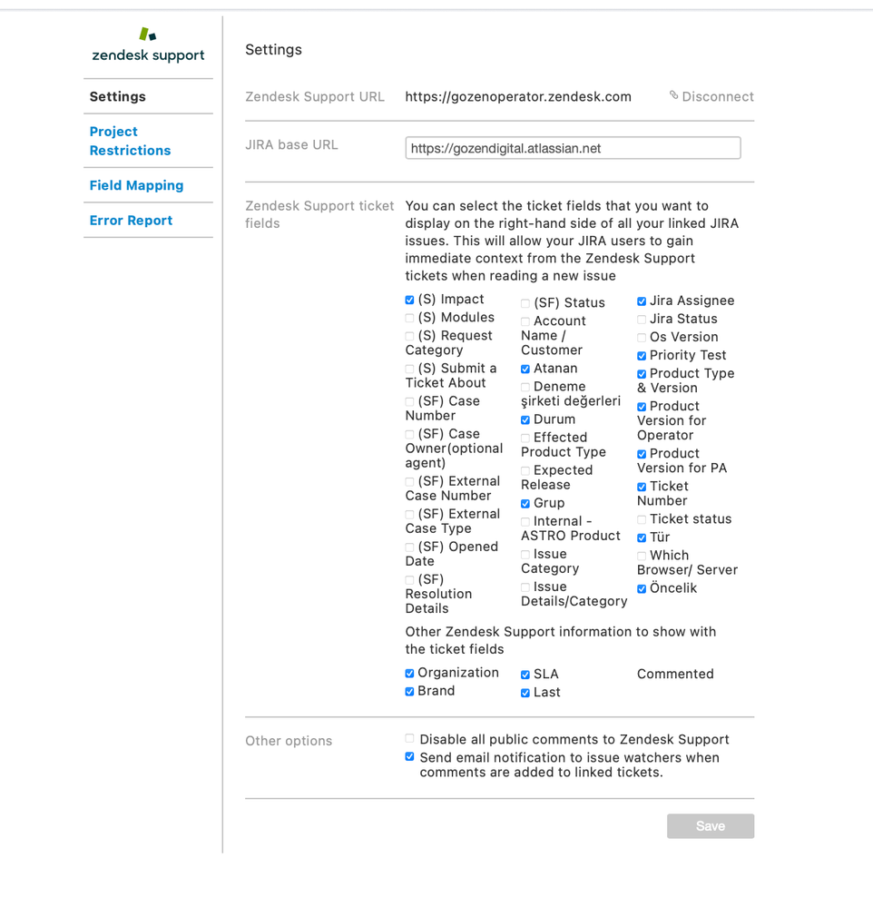

We use Zendesk Support for Jira.
When we change the "status, priority" fields in the Jira ticket, they do not change on the Zendesk side.

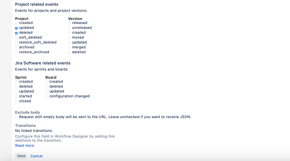

We created a webhook in Zendesk Support for Jira, but it still didn't work.

In your field mapping you are not mapping the Jira Priority or Status to Zendesk - you need to add that same way you have done for 'Assignee' and 'Priority Test'
