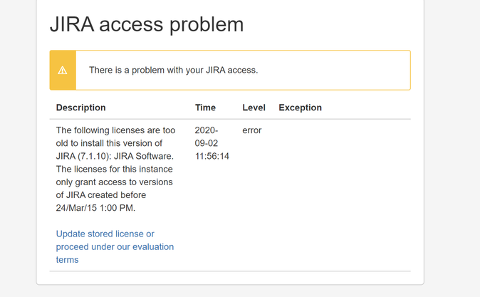

I have upgraded my old jira server + agile from 6.2.5 to 6.4 and it seems to be working, but after that I tried to upgrade to 7.1 and it is throwing below error.
Please let me know what can be the issue.
I do not think this is a very clear message in some ways, but it does tell you what is going on.
Your Jira has and old expired licence that ended on the 24th March 2015. Jira 6.2.4 was released before then, so you were entitled to upgrade to it, but 7.1 was released after it so you can not use it.
You say you have a valid licence for Jira Software - you will need to apply it to the system - use the link at the bottom for "update stored licence".
However, do not do that yet. Go back to your 6.4 installation and update the licence on that. Then perform an upgrade to 7.0.11
Upgrading from 6 to 7.1 or above has some problems, ones you may not even discover until you reach 7.8 or above. Do not skip 7.0.
Once you're on 7.0, you'll find an upgrade to 7.anything-you-want to be quite fast and error free (believe me, I was only doing 6.3 to 8.5 literally at 1am this morning, with an expired licence problem even more badly described than the one you have!)
You can only upgrade to a version that is released before the end of your current licence.
Your current one says 2015 on it, so a renewal isn't of much use, you should just buy a new annual licence - that'll enable the upgrade.
Correct.
Your existing licence gives you support, which includes access to any version released during your support period. It also lets you keep running your Jira, unsupported, for as long as you want after that time.
But if you want to upgrade to current, you must be supported, which means having a valid current licence.
Hi @PravinU
Do you have valid support for your Jira license?
It seems like you have not purchased support/ maintenance for your Jira license.
You can not upgrade to versions which are released after the support for you license expired.
Hence if you wish to upgrade to a Jira version which was released after the support for your Jira license expired, you need to purchase the support first.
Also checkout the below comment by Nic regarding the upgrades.
Since you have not been renewing the support for quite some time now, the best option is to buy a new license and use it.
You can't upgrade to newer versions in absence of that.

Hi @PravinU
Nic has already answered this query below. :-)
To restate, you can upgrade to a version of Jira which was released till the time the support for your license was valid.
If you want to upgrade to a version which has been released after your support has expired, you need to buy the support for your license.
This is a standard licensing practice and fair too.
