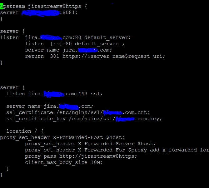

when i put the url i can not get the page. i have disabled in manage add on -> system-> activity stream plug in and i got this error. i enabled it again but still got that error.
here is the config file:

@Shannon SHaving the same EXACT issue. Please help! After upgrading from Jira 7.12.1 to 8.3 we are now having this issue. Our base URL is set to https://
Hello there,
Happy to give you a hand. For this error, this is usually due to a misconfiguration of the proxy or certain certificate related issues.
I would recommend to first bypass the proxy and SSL and see if you continue to have the issue:
You can use the below resource to test your SSL:
You will also want to take a look through your Jira Server Logs to see exactly where it might be failing.
If you continue to have issues, I would recommend that, if it's possible, please create a Support Zip. Raise a ticket with our Support Team and they will be able to take a look at your configuration and let you know what the issue is.
