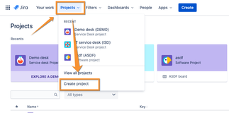

And you noted having admin permissions, so if you do have global admin the option to create a project should be visable in either the Project Drop down in the top navigation bar here:
