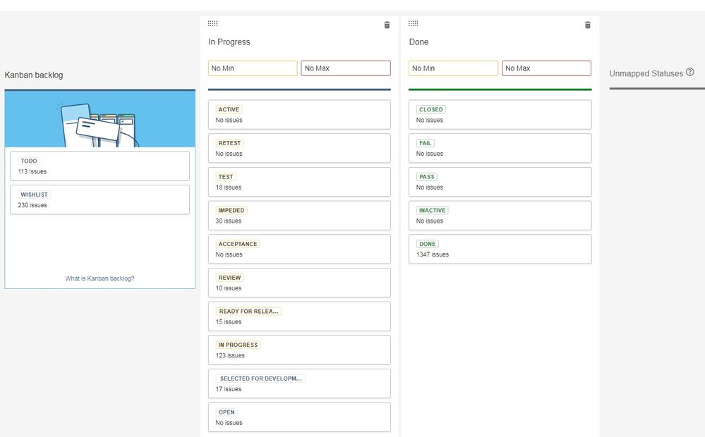

Configuring boards in Kanban: When I move Wishlist and Todo-items to the backlog and delete the Todo-column the backlog behaves weird and shows not only all items in progress but also sometimes gives an empty backlog.
Is that supposed to happen?

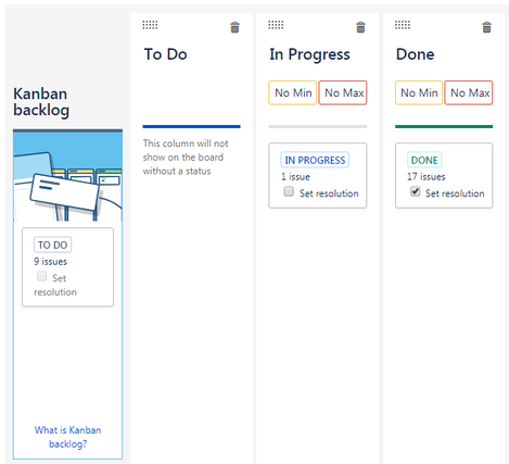

So according to your screenshot I guess you had issues in To do and Wishlist status, and also issues in the In Progress column in your backlog. Adding an empty column next to your backlog should do the trick:
Can you please try to do so and tell us if it helps?

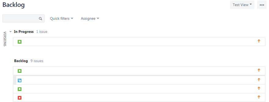

Then the first problem appears, the backlog is containing all items from In Progress
That's weird, it works well on my side:
Or maybe you don't expect the In Progress to be displayed above Backlog? I don't think we can do anything about it since it's the expected behaviour.
Per the details on "Use Your Kanban Backlog" the first section is always the first column on your Kanban board. Then your backlog follows. I assume this is to easily move items from your backlog into the first column (which in the Simple Workflow is "To Do") without having to leave the Backlog view.

I do, and the board works, but the back-log is not. It is adding other states to the backlog than the ones I specified to be in the backlog.

Ok, added that but instead of Issuetype I used Status. But then the Backlog disappears.
I think my solution has to be a work around, simply not use Todo as status. Thanks for your help.
