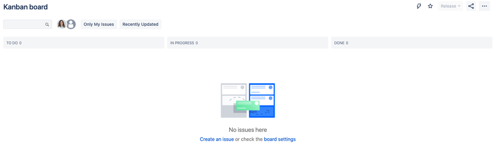

I'm trying to show in my Kanban board all the issues that I'm creating. My board configuration is the following:

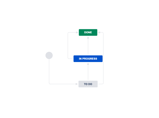

As you can see, my TO DO status in the column To Do, shows that it contains two issues. And my workflow configuration is the following:
I'm trying to check which permissions or settings are the related to "show" issues in the board, but I'm not able to switch them correctly in order to show those two issues.
Can you help me with this problem? Have you ever had heard about this?

I finally found the solution. If you create a new project with issues that do not require the Fix Version field, I recommend to you to apply this. If you remove that sub-filter, you can finally see all your issues. I fix my problems with that.

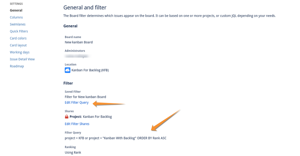

@Azahara CamachoCan you please open the board filter query in edit mode as shown below or copy the board filter query in issue search to confirm you able to view those 2 issues which are in TO DO status. May be you don't have permission to view those issue.

Can you share your boards filter here? You will find it under board settings general. Also it would be interesting if you use that filter and just do a JQL advanced search do the two issues show in the results?
Azahara Camacho May 3, 2021
Hi Jack,
yes, sure. This is the JQL query that my project has: project = "DRM" ORDER BY created DESC. If I execute this in the advanced search, it shows the tow issues. However, the board still does not show anything.
