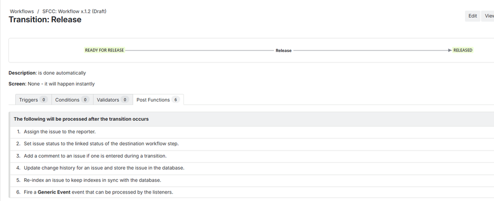

So this is the transition itself (to Released):
Yes, I want the resolution marked as done (without the status actually being called Done). We have two "done resolutions" in practice - One is Done (configured tickets), the other is Released (code released in fix version).
Finally, I want Released issues to remain in their status, not risking anyone to transition it to something else.

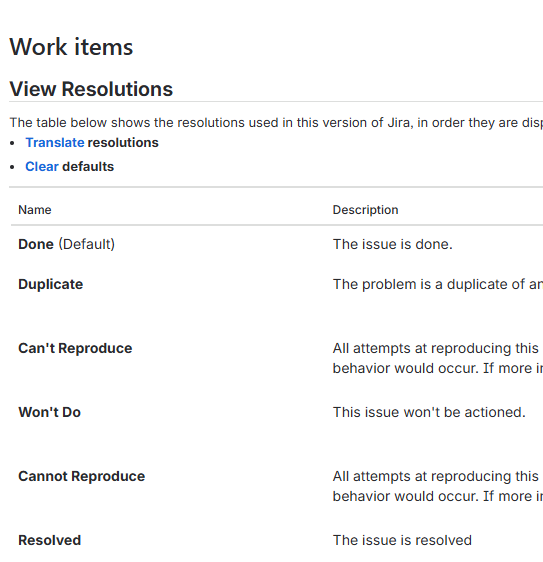

ok, first off you would need to create a new resolution, you can do this in Settings -> Work Items -> Resolutions.
Once done, if you edit the transition - perform actions - update an issue field - select resolution, if you have added Released to your resolutions, it will appear here and you can select it.

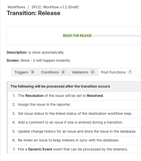

@jeff_trotman So this will at least solve the situation with the issue being marked as "Unresolved" even though it has been Released, right? Follow-up question to that, why did I have to add a custom one like that, would it not be enough to use the default Done?
1: Added the bottom item (Resolved)
2. Added it to the Post Functions of the transition from Ready for Release to Released:resolution-resolved.png
jeff_trotman August 19, 2025
Yes, now the unresolved work issues, will automatically become Resolved, once transitioned to Released.

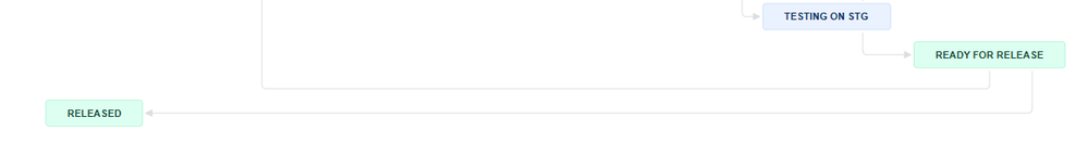

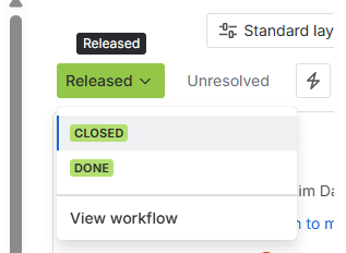

@Nikola Perisic The first obstacle is still this:
Workflow ends with "Released:
Yet, anyone can transition the issue within it to this (plus it says "Unresolved" which is not true according to our way of work):
So, I do not know where to edit the conditions.
