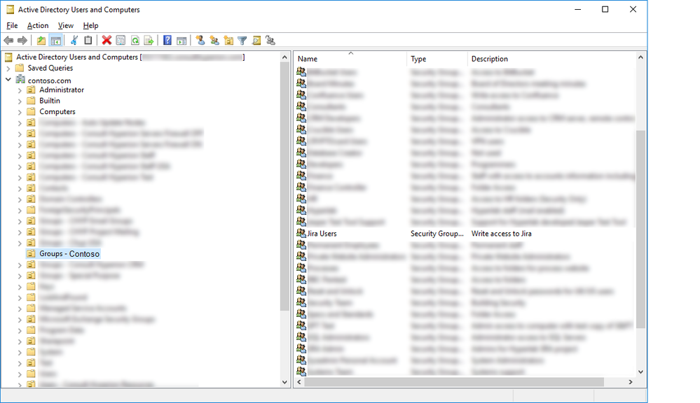

Are the group objects you're trying to pull in actually in the Jira Users container in your AD? I believe the space should be ok, but if the groups are in a different container (like if there's only user objects in the Jira Users container) then Jira won't be able to fetch any user groups that the users are members of.
If you've got a setup where the Jira Users container contains both the users and groups you want to use (basically like this screenshot but "Jira Users" being your container name instead of "Users")...
 you might consider using the Base DN field in the setup with the parameter
cn=Jira Users,dc=contoso,dc=com
and just leaving the other filter parameters at their defaults. Jira knows how to figure out the difference between users and groups with its default filter settings - if you can just point it at the right container or OU, it can sort out the rest if everything's in the same spot. Where you want to use those additional group/user filters is if the groups are stored in a different container or OU than the user accounts.
Let me know how that goes - or maybe a blurred screenshot of your AD U&C layout if you're still running into issues!
