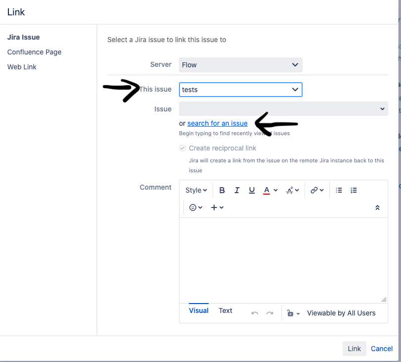

As these are too many to do manually, I tried to link them by following this path:
Test Plan > More > Link
Then under Jira Issue, I chose tests in the field This issue and clicked on search for an issue. Then I chose advanced search and typed in the query:
project = ProjectName AND fixVersion in (Version 1, Version 2) AND status = Approve
That's where no matter what I searched I got an invalid query message.

I made some screenshots with an example Test Plan. I hope that is clear. The Query would go in the advanced search from the last screenshot. Whatever I type into that advanced search bar is considered invalid.
