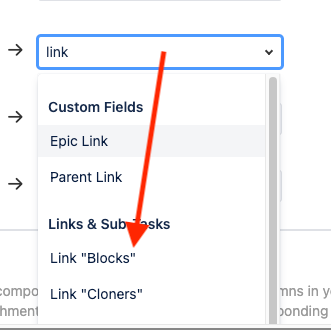

If you want to create links between a newly created issue and an existing issue via CSV you need to map the column that contains the existing issue key to one of the Links types for the type of link you want to create between the two issues.

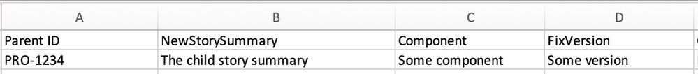

Trudy, thanks for the speedy reply. My question really is, which of those link types should I be using, so that the new story links to the parent? Here's the kind of information I have in the CSV file:
In other words, I want to create a new story and make PRO-1234 the parent. When I select the Link "Parent" option, mapping to PRO-1234, Jira creates the new would-be child as the parent of PRO-1234. If I choose the Parent ID option, Jira thinks I want to create a sub-task (even if I specify "Story" as the Issue Type.)

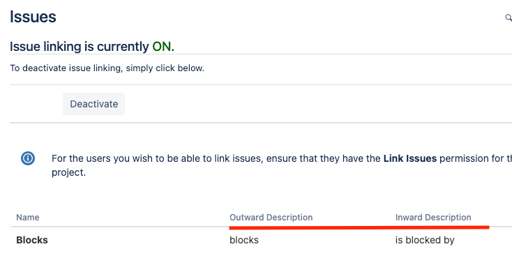

If you look at the Issue Linking configuration page you see the types of links that have been defined. Each one has an Outward and Inward Description. These are the descriptions you see when viewing an issue and looking at the Linked Issues section, describing how the issue you are view is related to the linked issue.
For the Blocks link type the configuration is
As per the documentation when you use this in your CSV import then the issue that you are creating will be Outward Description relationship to the issue you specified.
imported issue "blocks" specified issue.
