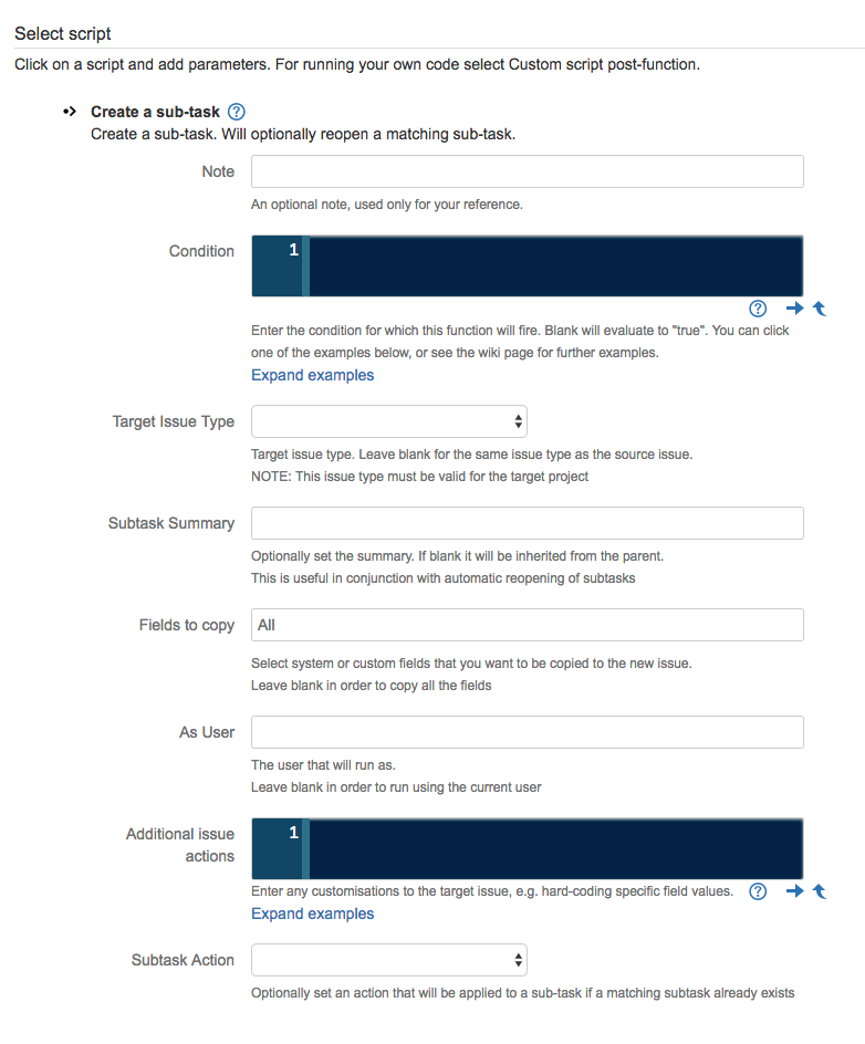

Hello Connor.
I believe this can be done with the SR Create Subtask post function.
Since it is a sub task, it needs to have a parent, so if you were to add this post-function in te onCreate transaction, it would create the subtask that you are looking for.
This is the dialog that you need to fill, and it can be accessed in the add postfunction dialog in the workflow transaction editor.
Screen Shot 2017-07-26 at 10.13.43.png If you have more questions do not hessitate to ask.
Cheers!
Dyelamos
