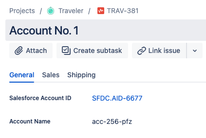

The updated compare is also not working. The problem is, that only one of the Accounts (from TRAV-360 to TRAV-338) has the same value as the RFQ, however, all of them pass?
As you can see, only one of the Accounts has the correct value in the Custom Field Salesforce Account ID, however, both of them are linked.

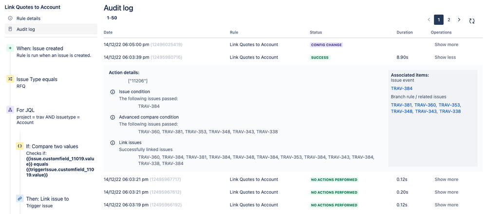

I was able to fix it now with the {{issue.customfield_11019}} in the first field of the If: Compare two values and {{triggerissue.customfield_11019}} in the second field.
This is what I see in the Audit Log. The problem is, that only one of the Accounts (from TRAV-360 to TRAV-338) has the same value as the RFQ, however, all of them pass.
