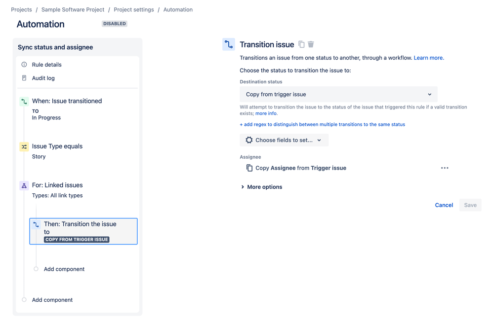

Walter Buggenhout
July 11, 2023
Hi @Hizkeel Khan,
The following automation rule should do the trick:
Screenshot 2023-07-11 at 14.05.24.pngHope this helps!

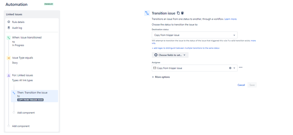

Hizkeel Khan
July 11, 2023
@Walter Buggenhout  - Thank you for such a quick response...Part 1 is working fine but part 2 is not assigning the assignee automatically. In the assignee field it shows "AJ" Automation for Jira...I have done everything you mentioned. linked issue.png

Walter Buggenhout
July 11, 2023
You almost did everything I mentioned 😉 - you need to specify you want to copy the assignee field in the last step:
Hopefully that resolves the issue!

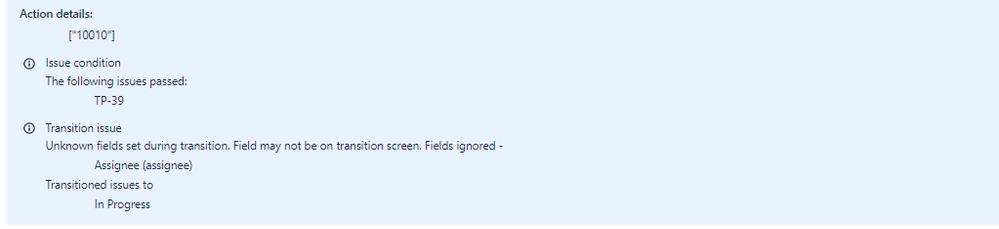

Hizkeel Khan
July 11, 2023
@Walter Buggenhout  - This is exactly what I have done but I'm getting errors. SS attached.
I have added condition in the workflow to automatically assign the ticket to the current user (who is making the transition). Maybe that's the reason why rule is failing. idk
Please provide me with a viable solution. Thanks.

Walter Buggenhout
July 11, 2023
ok, thanks for sharing the extract from the audit log. To make this work, you need to associate a screen to the transition in your linked issues' workflow with the assignee field on it (as the error message explains)
Another option would be to add an addiitonal action to the rule: edit issue, select assignee and apply the same logic separately.

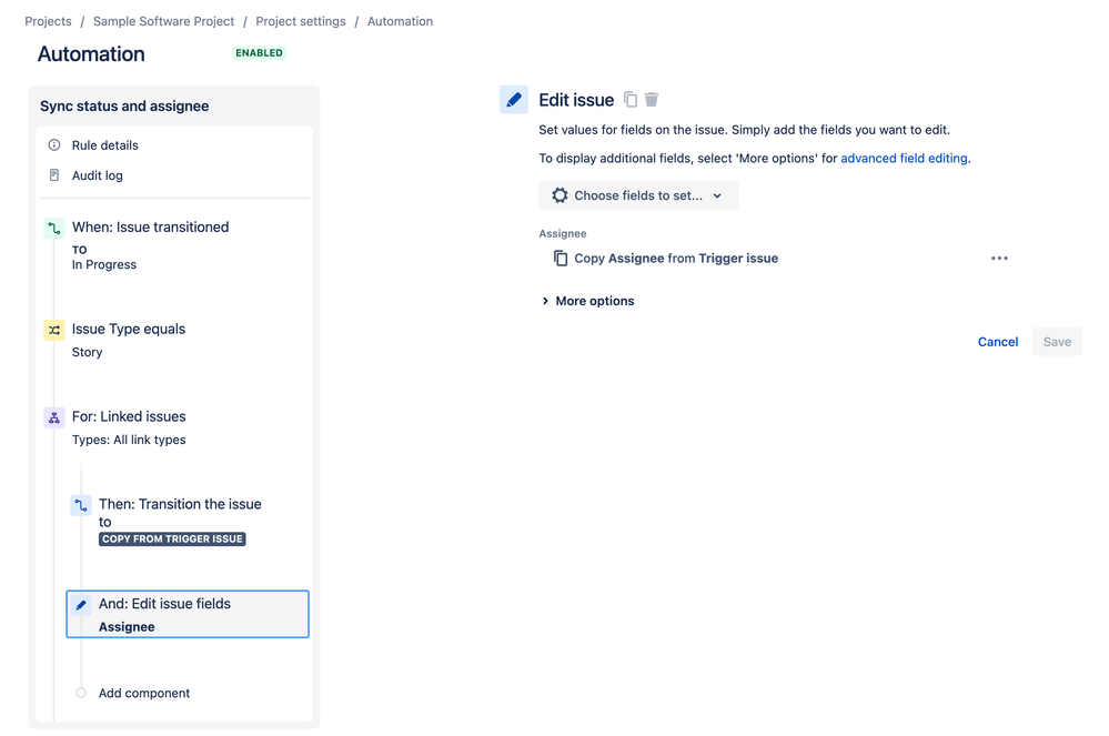

Walter Buggenhout
July 11, 2023
Let's go with the simplest solution here, @Hizkeel Khan. Remove the update assignee step from your current automation rule (in the list of fields to update during the transition, just unselect the assignee field).
Then add an extra action to your automation rule as you can see here. Tested it myself in my test instance successfully:

Hizkeel Khan
July 11, 2023
@Walter Buggenhout - Thank you so much! It works perfectly fine now.
