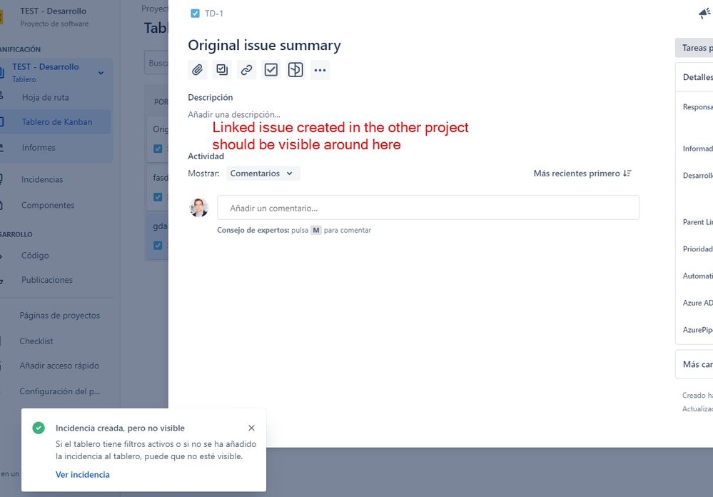

TD > TINF
Linked issues don’t show neither in PS nor in PW
Immediately after operation the pop-up in the bottom left corner appears:
Issue created, but not visible
If the board has active filters or if it has not been added
the issue to the dashboard, it may not be visible.
See incident

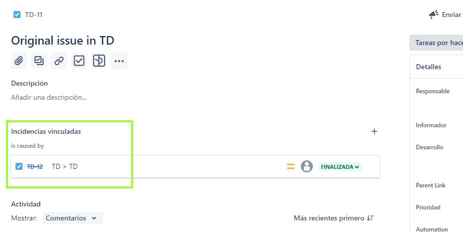

TD > TD
Everything fine, as expected:

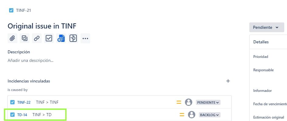

TINF > TD
OK
TINF > TINF
OK (see image above)

Apart from that I reproduced the setting in a different cloud instance with out-of-the-box project configurations and the situation is the same, so I'm starting to think that the problem is my lack of knowledge about how Jira Software projects work.
Maybe if a task in a Jira Work Management project is created from a JS project task, then the linkage isn't visible in either of them for a reason or under certain conditions. I don't know.
