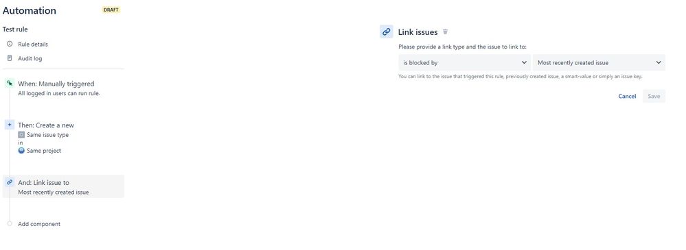

I've a manual automation in X project and when I run that it will create a task in Y project.
My question here is how to link both these issues when that manual automation rule is triggered?

@Vishnu you can simply use Link issues action in the same rule, where you can define that the most recently created issue is linked to trigger issue (i.e. issue where the manual rule was triggered).
