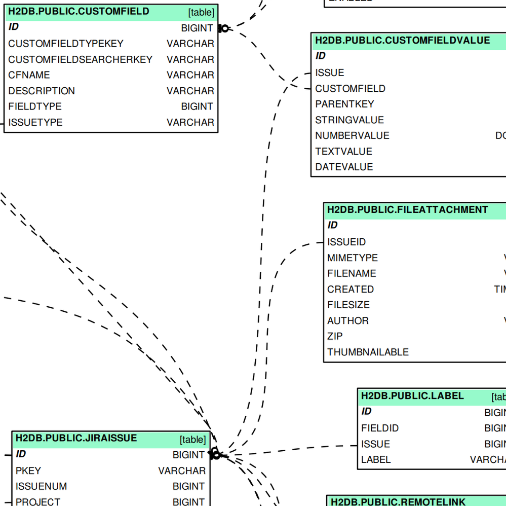

Every issue has an entry in the JIRAISSUE table with its own numeric id.
Likewise, every custom field is represented as a row in the CUSTOMFIELD table with its id.
There's an intermediate table between both of those tables named CUSTOMFIELDVALUE, each of which rows contains one issue id, one custom field id, and the stored value:

That said, NULL values simply do not have a row in the CUSTOMFIELDVALUE table.

I believe the answer to your question is going to be NULL.  Depending on what information you're looking for, here is the database schema for JIRA.
You can use it to create queries and determine how the database is layed out.  In addition, at the top of that article is a jar file depending on whether you're using JIRA 5,6 or 7 to generate schema information for the JIRA database.  Here is the one for JIRA 7: jira-schema-diagram-generator-plugin-1.1.0.jar.
