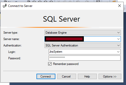

That's exactly my point of frustration - using SSMS my Jira login/user can connect just fine to the database in question (freshly created for the use of Jira Software).

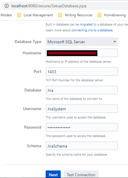

The shots below are the users of the new database (JiraSystem in this case), then the SSMS login which I use to connect from the Jira server (successful connection), and then the installation details from the Jira install screen.
The "test connection" has just been timing out for me. That's why I'm banging my head here. It's probably some tiny detail, small and stupid, that I'm overlooking. But where I sit, it looks like all the stars are aligned correctly...it just bombs on me. And it shouldn't - if SSMS can connect and be happy, what's up with the Jira installation? What didn't I give it?

Thanks for the reply - yes, these are all taken from the Jira server. SSMS connects from the same VM to the SQL database from the Jira server. It's all the same client talking to the server.
