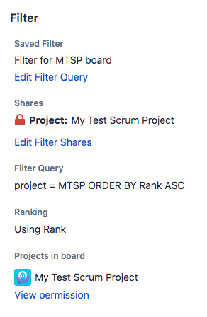

Hi Carlota,
As I mentioned, if your 2 boards have the same JQL filter behind them, then issues in board A will appear in Board B.
To avoid this, do the following:
For example:
If I have another board for the same project as the above, I would click on Edit filter query and then update the query
project = MTSP ORDER BY RANK ASC
to
project = MTSP AND issuetype = bug ORDER BY RANK ASC //for board A
and
project = MTSP and issuetype != bug ORDER BY RANK ASC //for board B
in the above, issue type is the distinguishing property.
This will be done on both boards.
Save the filters and this should restrict issues from showing up in boards they are not meant to because users are meant to add/select the distinguishing property when creating the issue.
